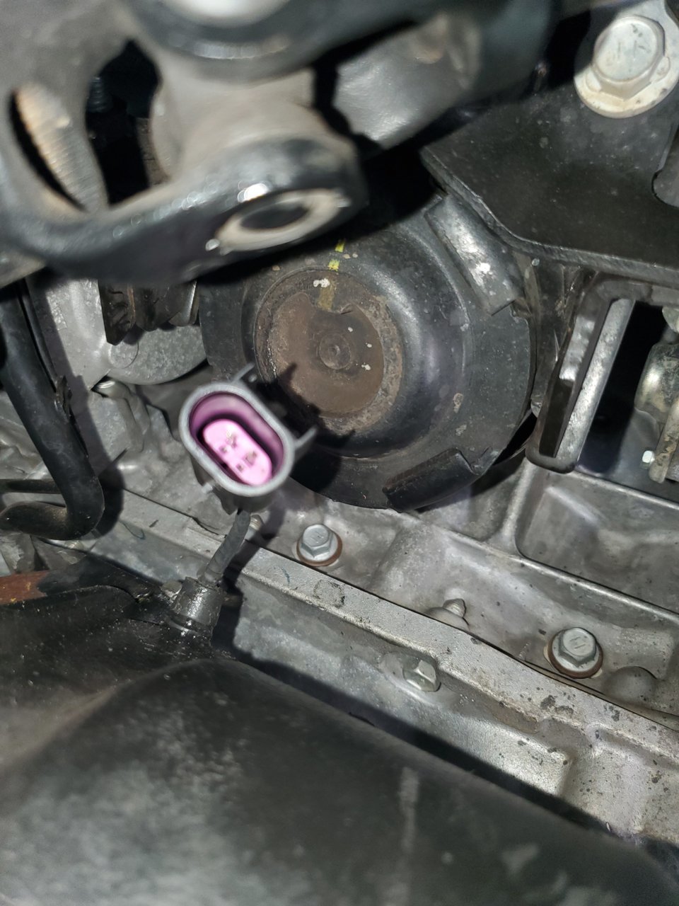

    Hello TW,
    Got my 5.29 gears with front locker installed. It was a brutal 6hr drive home from S-cal.
    Only thing i had to do was the wiring. After installing the wires my locker wont engage. Wiring is pretty straight forward so im sure i didnt miss anything. I have 12.4 volt at the plug before going to the diff.
    Did a little research and was told that I should hear the pin engaging when on?
    Any help would greatly be appreciated.

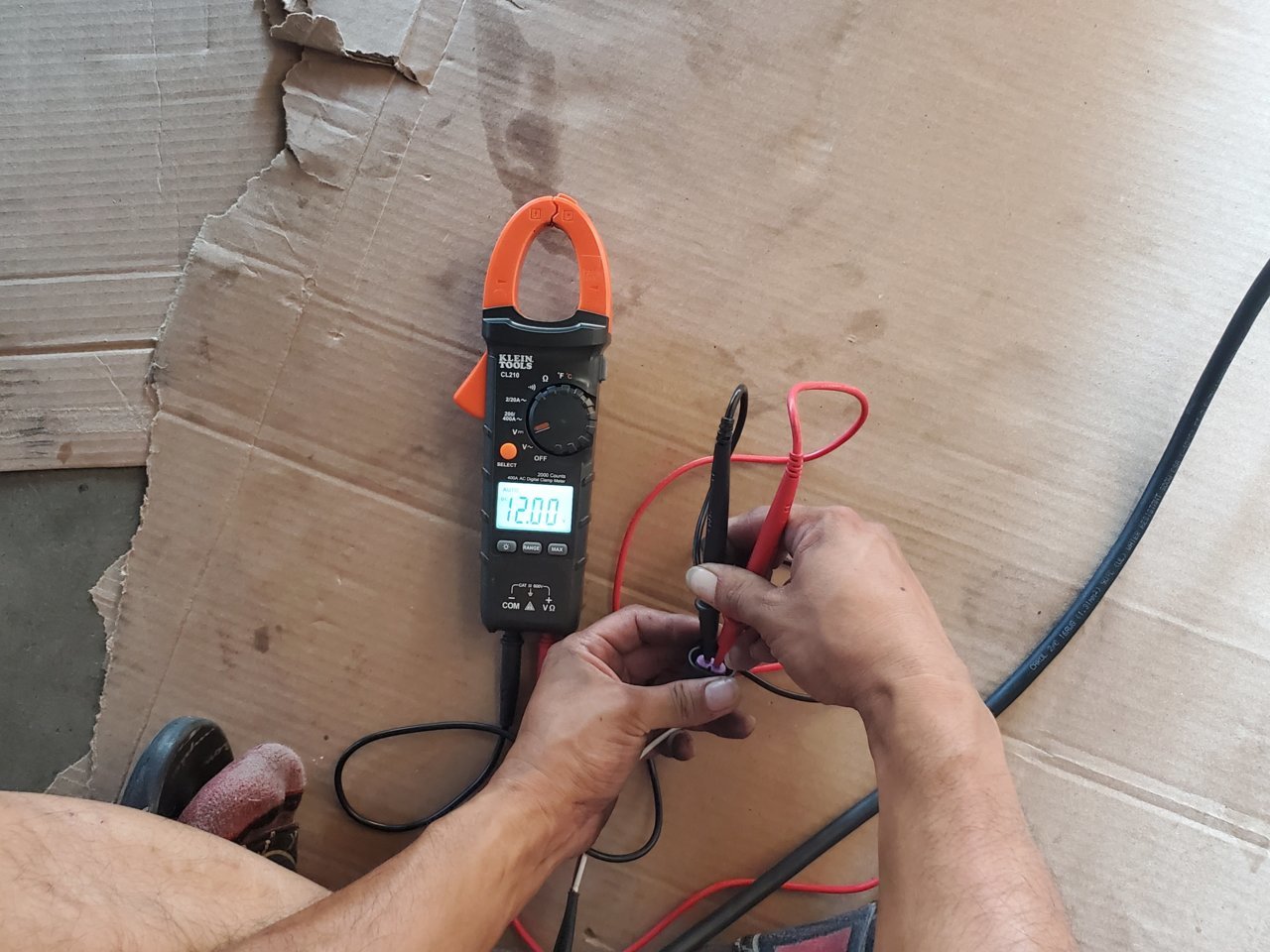

  17. Aug 9, 2020 at 9:58 PM
    #17
    sig916
    sig916 [OP] Well-Known Member
    Nov 2, 2014
    #141536
    893
    Yes rely clicked and it messured 12+ volt at the end of the plug before going to the diff side.

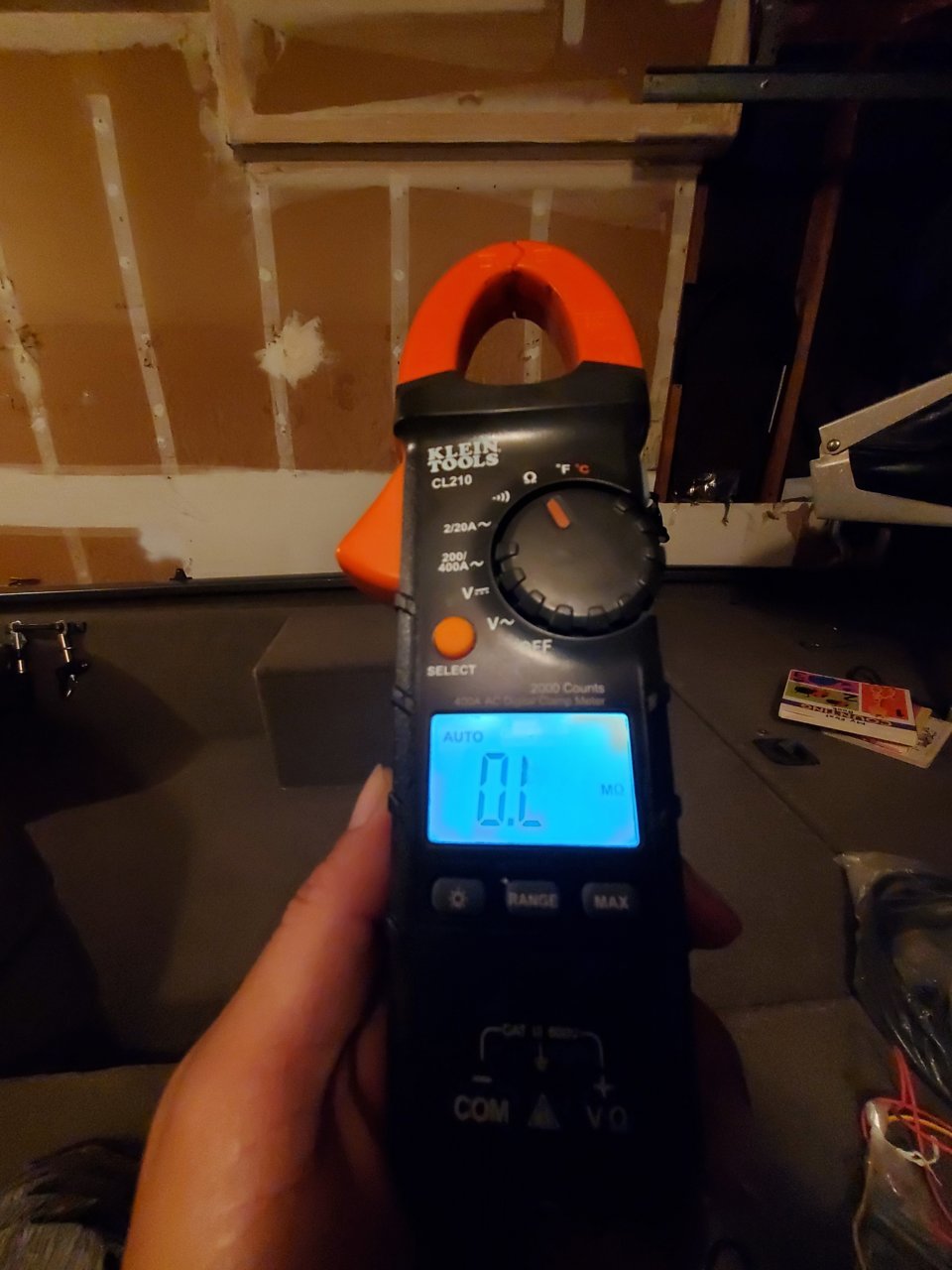

  19. Aug 9, 2020 at 10:13 PM
    #19
    sig916
    Nov 2, 2014
    #141536
    893
    Ok it beeped

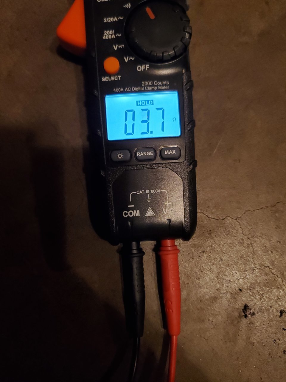

  20. Aug 9, 2020 at 10:14 PM
    #20
    sig916
    Nov 2, 2014
    #141536
    893
