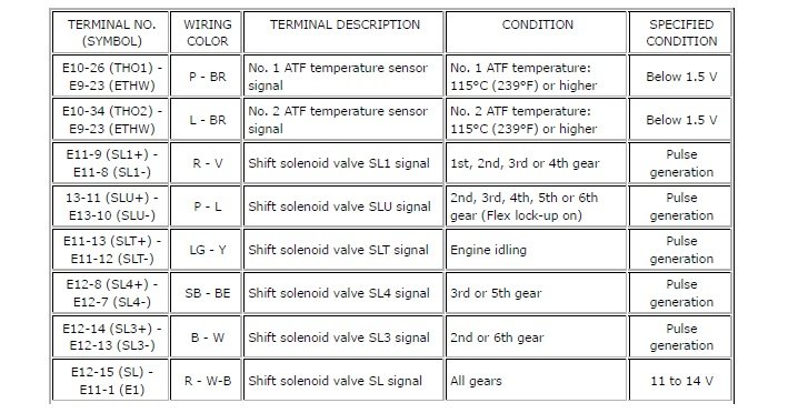

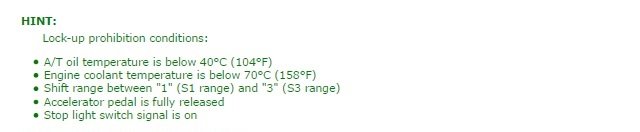

    @gearcruncher
    Lock-up is prohibited under these conditions...
    Does flex lock-up have the same prohibitions?
    Regardless, it is not active in 1st.
    Could this be a potential clue?

    I was hoping gearcruncher would. :oops:
    As I understand it...
    Traditional lock-up is achieved through electronic control via solenoids SLU(on/off) and SL(pulse width modulation).
    Flex lock-up(a.k.a. half-lock) is achieved through electronic control via the torque converter clutch solenoid SL(pulse width modulation).
    Supposedly, makes the shifting experience more pleasant and increases fuel economy.
    My uneducated theory is, if flex lock is not prohibited by the same conditions as full lock, it is not disengaging the torque converter clutch from the 2-1 shift via solenoid SL.
    As prohibition conditions subside, solenoid SLU kicks in and/or it goes into a different lock-up strategy.
    Putting it in S3 supposedly cancels flex lock; can't remember where I saw it though. Coincidentally, I've never experienced the harsh downshift. I've pretty much avoided D and have used S-mode from the get-go; and now, S-mode with ShiftSense. Maybe those experiencing it can try S3 and see if it makes a difference.
    @OVTune would probably be the best qualified to comment on the lock-up strategies.
    Sorry for all the edits...
