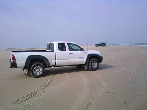

    I had the TSB done but don't have 5100's. I have a pretty vicous rake, and I only haul occasionally so mine rear end never really settled down. Let me look through my pics.
    PS. If 2.5 is too high can't you just set them to 1.75?

    Here is a pic on about the most level ground there is:

    Altered, i think we have the same truck. I have 5100s set at 2.5 with the tsb and a 1inch block. It sits a little higher in the rear, but i love my stance. I think with just the tsb you should be just a little high in the front.
