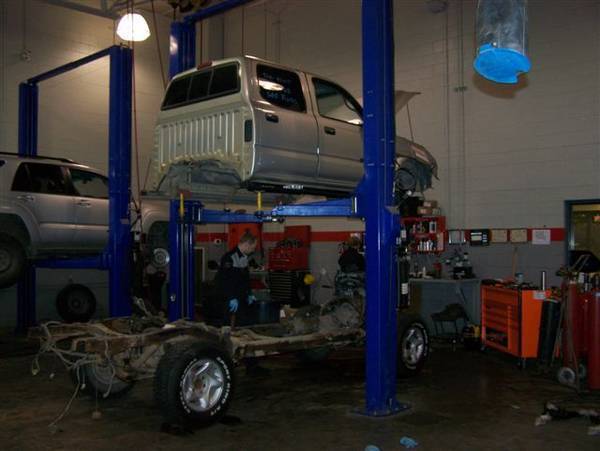

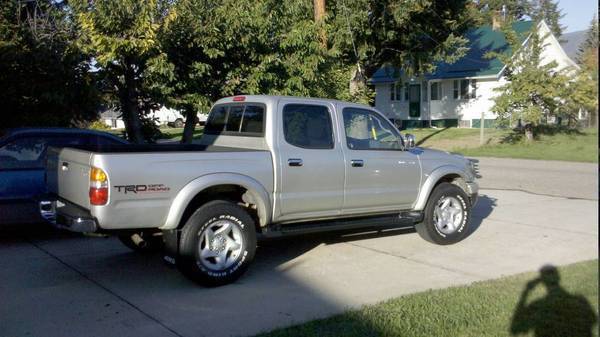

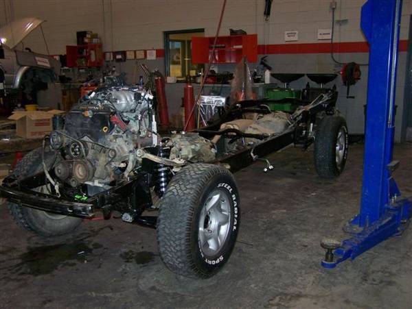

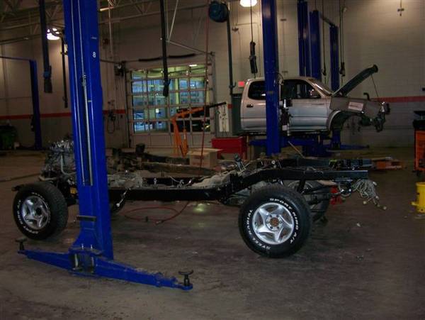

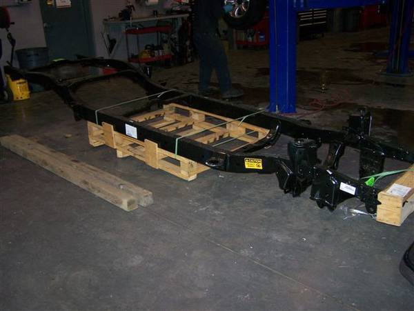

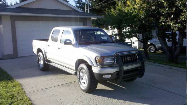

    Had mine done Nov. 2010
    Before:
    [​IMG][​IMG]
    during:
    After (with 5100's ome 881, icon aal)

    I just took it in and said there was a recall on my vehicle. The guy looked up all the recalls and came up with 2: Frame and a recall for a fuel line shield.
    They scheduled me for a frame spray treatment and found a 5 inch hole on one side, and a 7 inch patched hole on the other. I was told I couldn't take my truck and they would be replacing the frame. 24 days later I had a practically brand new truck!
