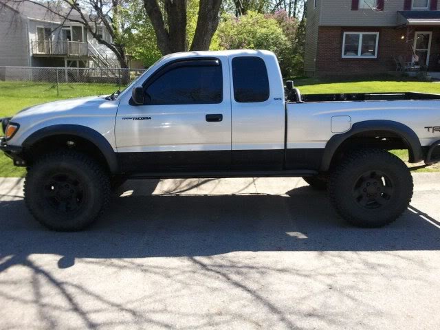

    i did mine a while ago. here is what 3 layers of herculiner looks like after 3.5 years with no touch ups.... pretty damn good if you ask me!!!

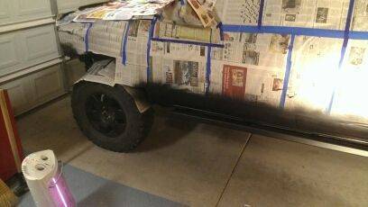

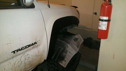

    I did mine about 6 inches up. Let me find some pics.....

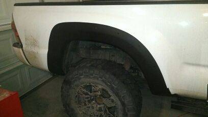

    Also took of my flares and did those.

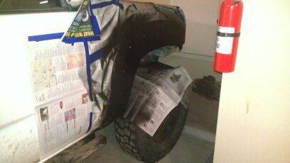

    I don't know about the hurculiner type of stuff but the Walmart spray on bed liner is what I used. Prep was just the masking everything off and then 120 grit wet sand paper (used dry) to scuff everything up and then spray. But this is the interesting part........if you hold the can upside down about a foot away from the material to be sprayed and then nice even spray strokes.

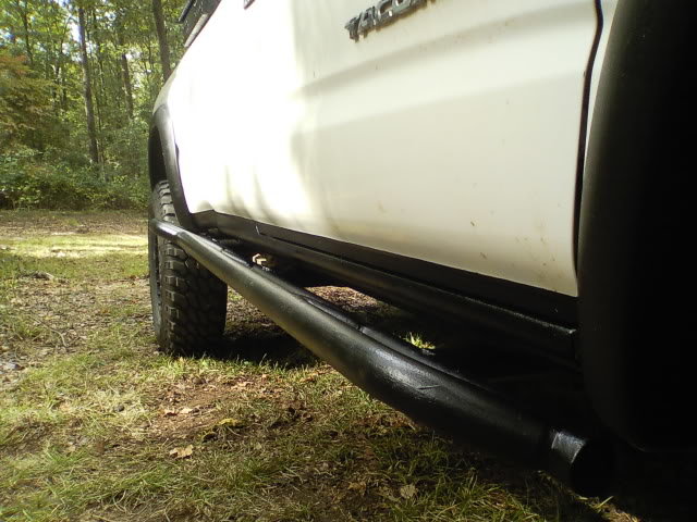

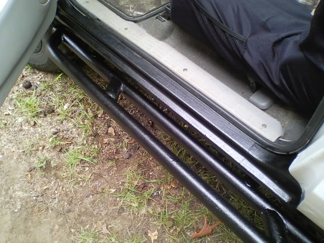

    did everybody spraylined the inside portion of the rocker panel (on the first pic)? im about to do mine and i wasent gonna do it, im guessing its just for the look :confused:

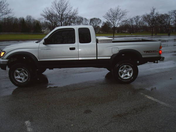

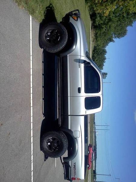

    Kurt from Cruiser Outfitters personal Tacoma. He has line-x'd rockers.
