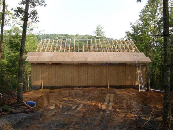

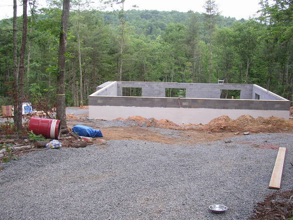

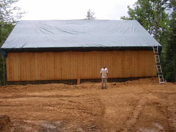

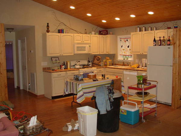

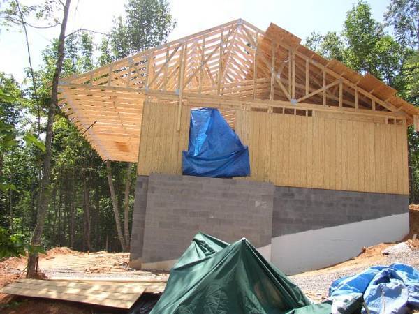

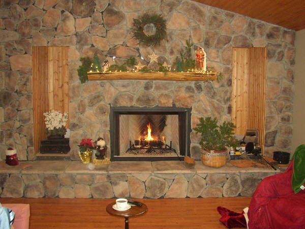

    I live in North Carolina and bought mountain land in Virgina in 2003 and spent 4.5 years building a mountain house on it (second home/weekend home)…built on weekends and vacations since I have a full time job. Absolutely had a blast building it (got final certificate of occupancy for the upstairs, then got a 'remodel' permit and I'm now still finishing the basement into 2 bedrooms and a bathroom).
    I already had some experience with building a few sheds and light electrical and plumbing…did a ton of research on the internet. And scoured the building codes book.
    Things I hired someone to do: excavate the foundation and pour footers, put up the concrete block walkout basement, pour the concrete basement floor, septic and water, crane for roof trusses and HVAC.
    Everything else I did myself (with help from my dad): framing, electrical, plumbing, roof, insulation, drywall, etc.
    Had it inspected of course, didn’t run into any problems there, the inspectors were great to work with, and answered whatever questions I had on the phone.
    I have a ton of pictures, here’s a few.
    With the concrete block basement built
    Initial framing done
    Roof trusses pre-built and put up by a crane, start of roof underlayment
    Side picture
    This is a picture from the end of the 3 full weeks I took off to get as far as I could, pretty much dried in

    Picture of kitchen (which is open to family room)
    Picture of the fireplace...our favorite part of the house
