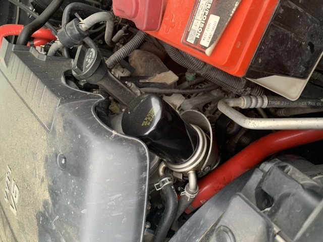

    Can you possibly post a picture of what it loos like on the truck?

    Sure. I think I get about an extra half quart, not much.

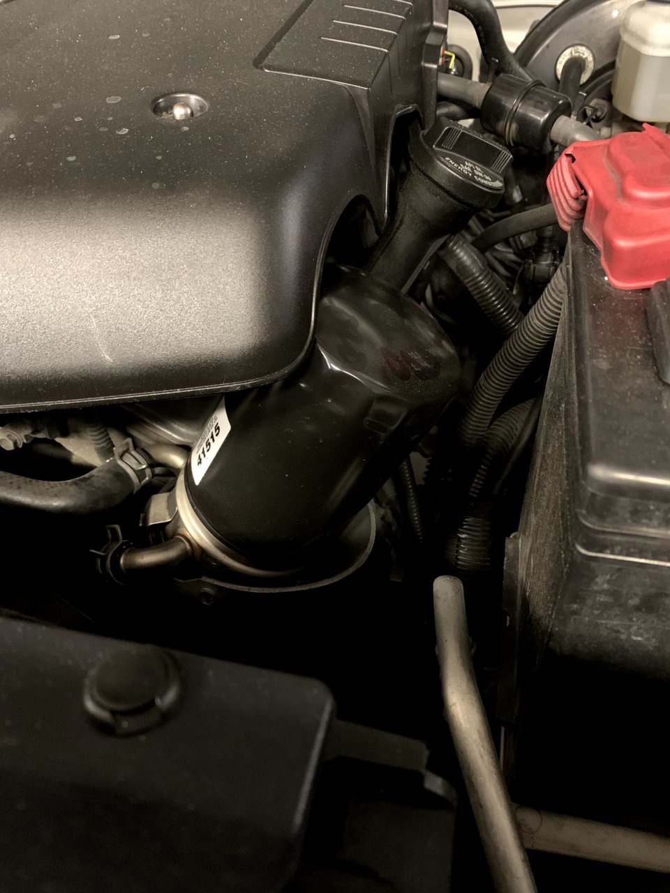

    here is a pic of the Napa 41515, the same size as the Mobil1 mentioned. Purolator PL30001 and L30001 will fit too. Fram PH8A(same filter as used on old small block Chevys) and Motorcraft FL1A (I think that is the number, same filter as used on older small-block Fords)
