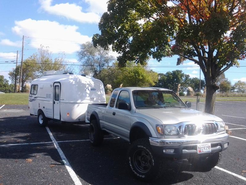

    3700lb camper is alot of weight for a first gen. I tow a 2400lb camper with my 04 v6/manual trans taco 4x4 TRD. I installed a class 3 hitch and brake controller. I also upgraded to the 231mm tundra front brakes, which made a BIG difference in my trucks stopping ability. You may want to consider either a smaller/lighter camper or a bigger truck.
