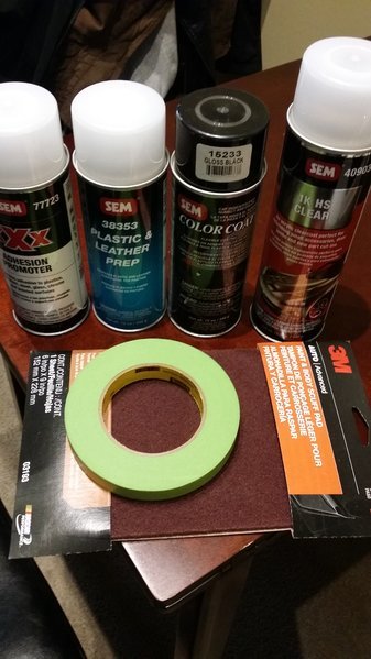

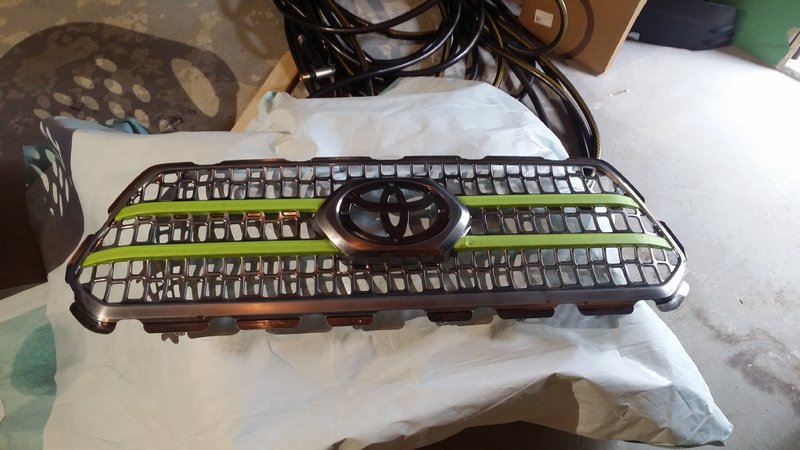

    brich999
    brich999 Well-Known Member
    Jun 18, 2016
    #189910
    1,403
    Bryan
    16 Tacoma TRD Sport AC
    all tore up already
    Abs plastic is difficult to get paint to properly adhere to. The chrome isnt going to be able to be sanded off, but with time and patience and some help from tech support i was able to paint my grille pretty well. Well iver a year later it still looks good except for the small areas i didnt scuff enough. Heres an idea of what i did
    I was told by sem tech support the most important things would be scuffing, plastic and leather prep (amazing cleaner btw!) And the adhesion promoter. Wouldnt recommend self etching primer as its ment to be used on metal(atleast any kind i sell or have seen)
