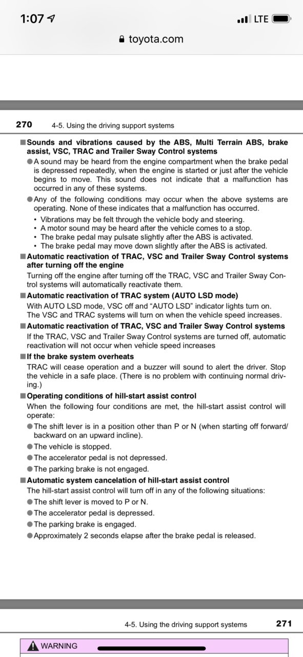

    I just got the truck back from toyota of greenville. I went on a ride with the service manager. The truck stalled at the first click of the hill assist brakes. He said “oh yeah, it’s gonna do that”.
    I am going to call Toyota next.
    What should I do?

    How soon after you let off the brake does it stall?
    Hill assist is only active for up to 5 seconds once initiated.

    I think you might have the wrong impression on how it's supposed to work...it's not hill-hold, it's hill-assist.
    It's purpose is to slow backward descent, not stop it. The slip indicator light comes on when it is functioning.
    The stalling part of it could be on you for operator error.

    I don’t think you are understanding what hill assist is.
