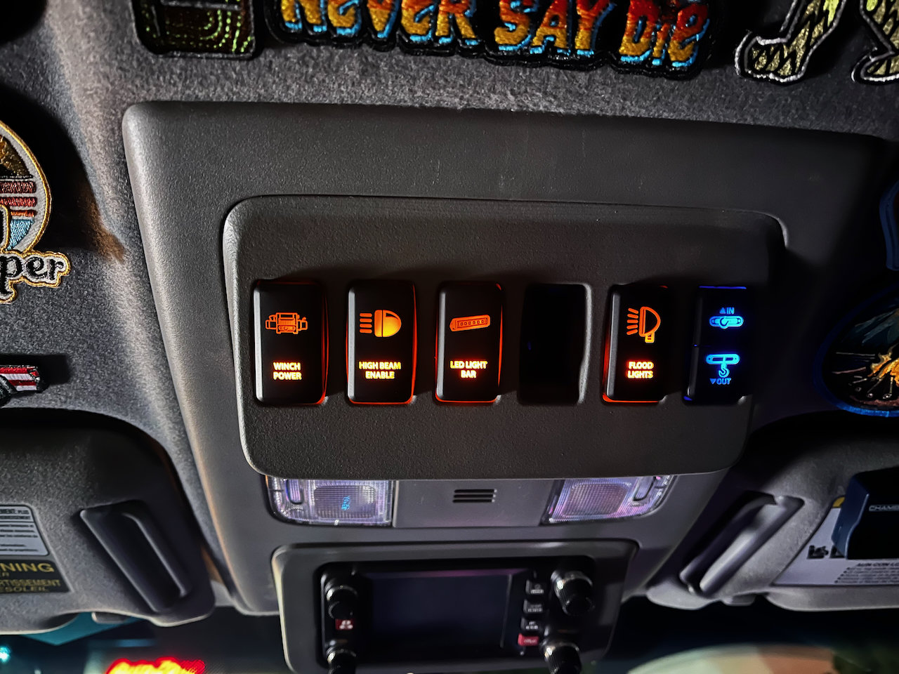

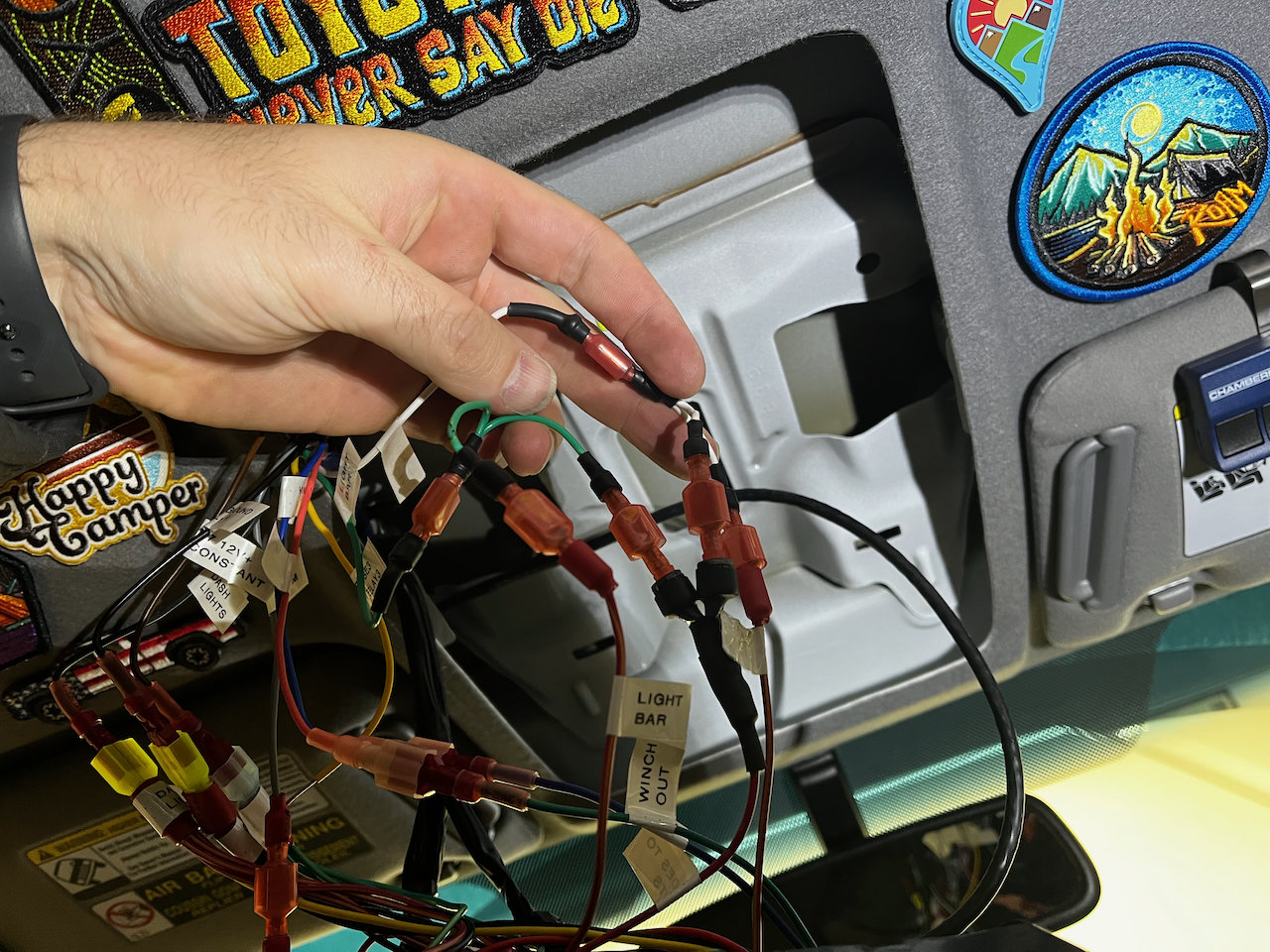

    I've used the V-series rocker switches, but not in my Tacoma. You are looking for a DPDT switch.
    On my Tacoma I used the CH4x4 switches, with some relays and Diodes to set mine up. I can individually turn them on, or enable them to turn on with the high beams. I used the diodes so the individual switches dont backfeed the other relays.
    I used some speed wire to get the wires to the underhood RMTR relay box. The diodes and switches are packed behind the Meso Customs overhead switch console.

    The lower part of the switch illuminates with the accessory lights (the first click on the stalk) the upper part of the switch illuminates when the switch is on. The switch lighting is one of my minor gripes about those switches, it's not the best. Sometimes it's too bright. Sometimes there is bleed from the lower part to the upper part. Depends on the switch. And honestly I have not really paid attention. It's out of my field of view when driving so it's not something I notice.
    None of my switches are white. They illuminate in the color you choose at checkout.

    How did you wire the diode into the wire?
  15. Jun 11, 2024 at 6:21 PM
    ZColorado
    ZColorado Well-Known Member
    Nov 6, 2020
    #345998
    1,106
    Near Boulder Colorado
    13 DCSB OR 6MT
    35's,Kings, NWF, 488, Harrop, SPC, Archive, Method, RCI, C4
    Probably crimped it into a butt connector and covered with heat shrink.
