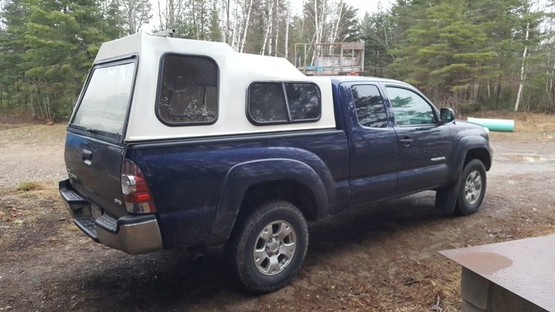

    the 5 spd is everything you need to make that truck work as long as you've got enough rear suspension to handle the load. I used to freight my old '89 4cyl 22re but I beefed it up in the rear with some NWOR 750lb over HD leaf springs. Those die hard 4cyl's like their rpm's. I find my 2.7 is just starting to get into the sweet spot at around 2500 rpm's and it feels just like a 2 stroke power band that's coming together at around 3000-3200rpm.
    I imagine that 2.7 would be a pig with an automatic transmission but I really have never driven one so I don't know. With that 5spd you can make it do anything you want it to do providing your suspension will take it.
    Here's my '12 in need of some viagra or something for the rear suspension, I'll get to it someday. Time is not the same now as it was before we had children :)
    Pete
    Whitetrash[OP] and 02Duck like this.
