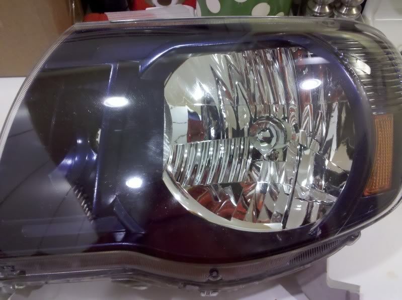

    sorry it took me so long to get back. i actually got really mad at these. i got them finished and when i put them in the oven the paint flaked off. and its taking me forever to get all of the paint off now and i havnt had much time to work on them. but i also got the turn signal cover too dark so now im just going to do the bhlm. but heres one completed, just not on the truck.

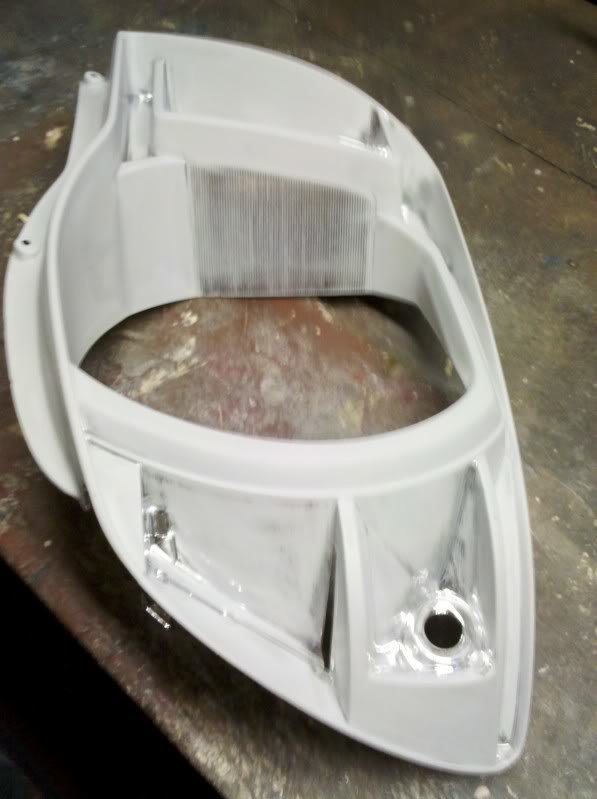

    Agreed, the chrome does come off pretty easily. Just time consuming. Just finished my drivers side light. passenger side is next....
    Almost done sanding...
    After the first coat of primer
    and checking out how it'll look once its back together.
