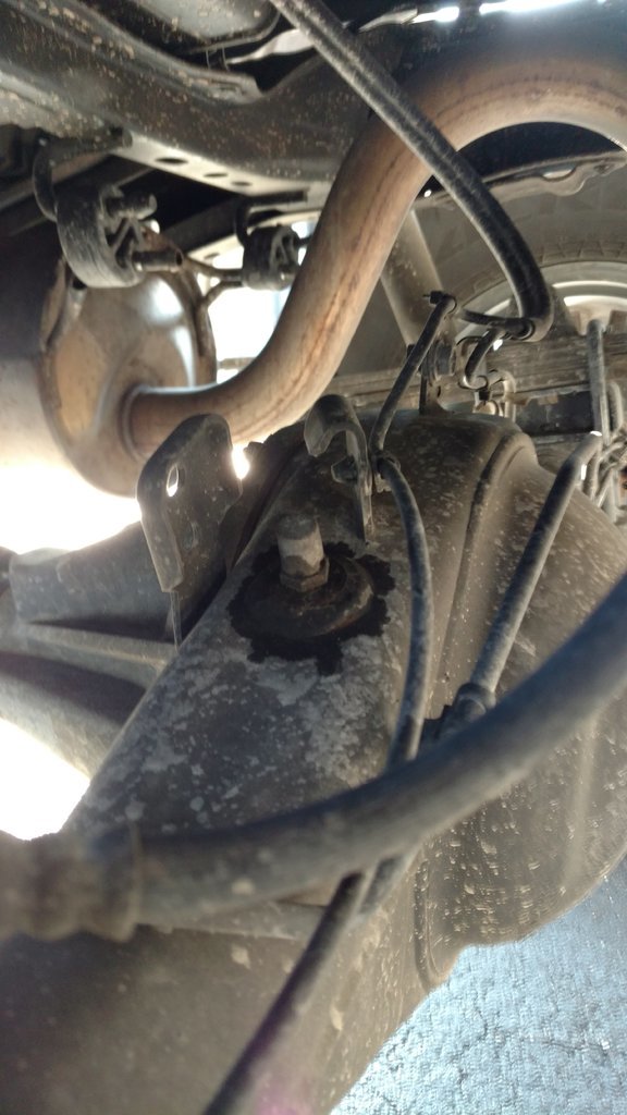

    Found this today...
    How concerned should I be?

    Looks like the breather puked a little oil, doesn't look like a big deal.

    Drive thru deep water lately?

    No nothing more then 6" or so.

    Check your diff fluid level. Should be hard to over fill but...
    Miles on truck?

    18,000 no problems. Went in for the diff bolts to be tightened at 15,000, not sure if that's relevant.

    I would hope the Dealer inspected the fluid level when you had it in for recall.

    It's just a burp from your breather. There are several threads on the breather mod that eliminates this.

    Diff breather mod is easy to do. Just got to get the same barbs on each one. Or not I ended up with 1/4 on diff and 5/16 on breather and 1/4 inch hose. But it worked fine.
