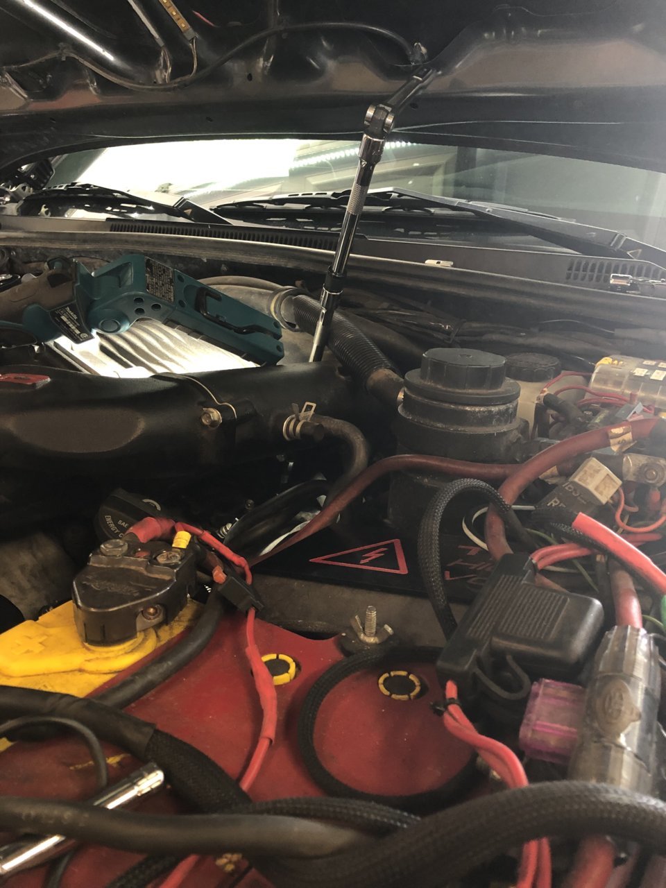

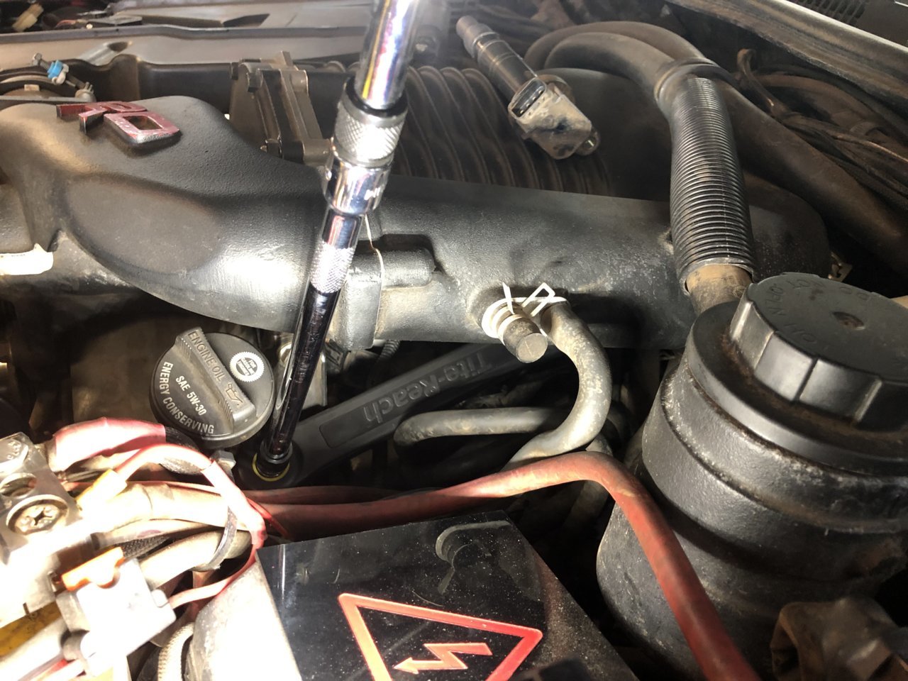

    I've got to change out my plugs and I'm looking for a little bit of guidance. Specifically speaking getting to the ones on the driver's side. I see some say that it's necessary to remove the s/c to get access which sounds like a real PITA. I've seen mention that it can be done w/o removing the s/c though and I was hoping that someone who has done this method can point me in the direction of a How To or perhaps shed some light on this with some details.

    I've read from a few people on other forums now who say you can do it using two 3" adapters and a ratchet with a plug socket. I think I'm going to try that before I take the s/c off.

    Meh, not ideal: Click me. Putting everything back together now & getting ready to put the new pulley on. I'll be glad when this is done.

    Nope. Be careful to pull the intercooler cover off because on mine part of that one stuck to the cover and the rest stayed on the bottom so I can see where it might have broke/tore had I just yanked it off. I can also see where the s/c to head gasket could be a pain since it's underneath the s/c and you can't really see it. It went relatively smoothly once I admitted defeat and decided to just remove the s/c to access the plugs rather than trying to get them changed while it was on. Since I had a new pulley to install the belt had to come off anyway so I wasn't too many more steps from pulling the whole thing off. I was hoping to be able to do it w/o pulling the s/c though that way the next time I need to change plugs I wouldn't have to pull it. The next time I need to change plugs I'll need a new belt anyway so just an excuse to do everything at once.
