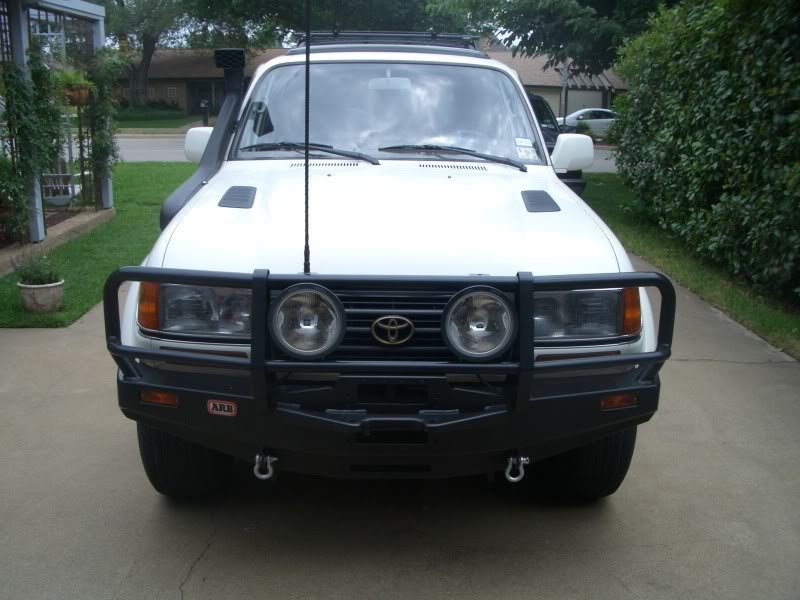

    True, its just when you crawling at low speed there is not enough RPMS and speed to help cool the truck. at idle your fan will spin at most 750 RPMS, so having electric motor to keep fan RPMS at atleast 2500 RPMS with out increasing heat output of engine itself would be ideal.
    I keep my hood unlocked on those days to give extra air flow but would rather have electric fan. Some people cut ribs into the hood to help with air flow but in winter they are problem due to snow and ice collecting on engine parts.
    here is the link on LC forum with how to for vented hood
    http://forum.ih8mud.com/80-series-tech/386741-my-newly-vented-hood-20-photos.html
    and final pic from their thread
