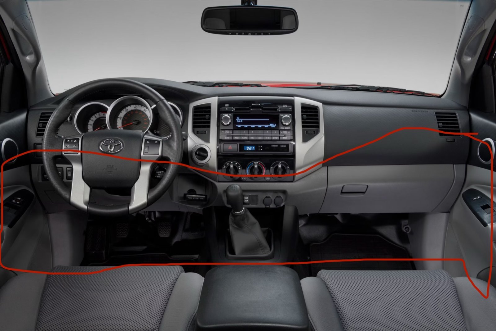

    I was wondering if anyone had ever blacked out this area of the 2nd gen tacoma and if so how. The cheap grey plastic bugs me and is the only thing making me want to upgrade to a third gen.

    I’ve done the dash and console. I wish the lower crash panels door panels were the dash color too

    It can be done. Just need to take it apart, prep the crap out of it and spray with some plastic/vinyl dye. Prep is key. Have to make sure every bit of interior cleaner/shine juice is off of it

    Cerakote paint in air dry form.

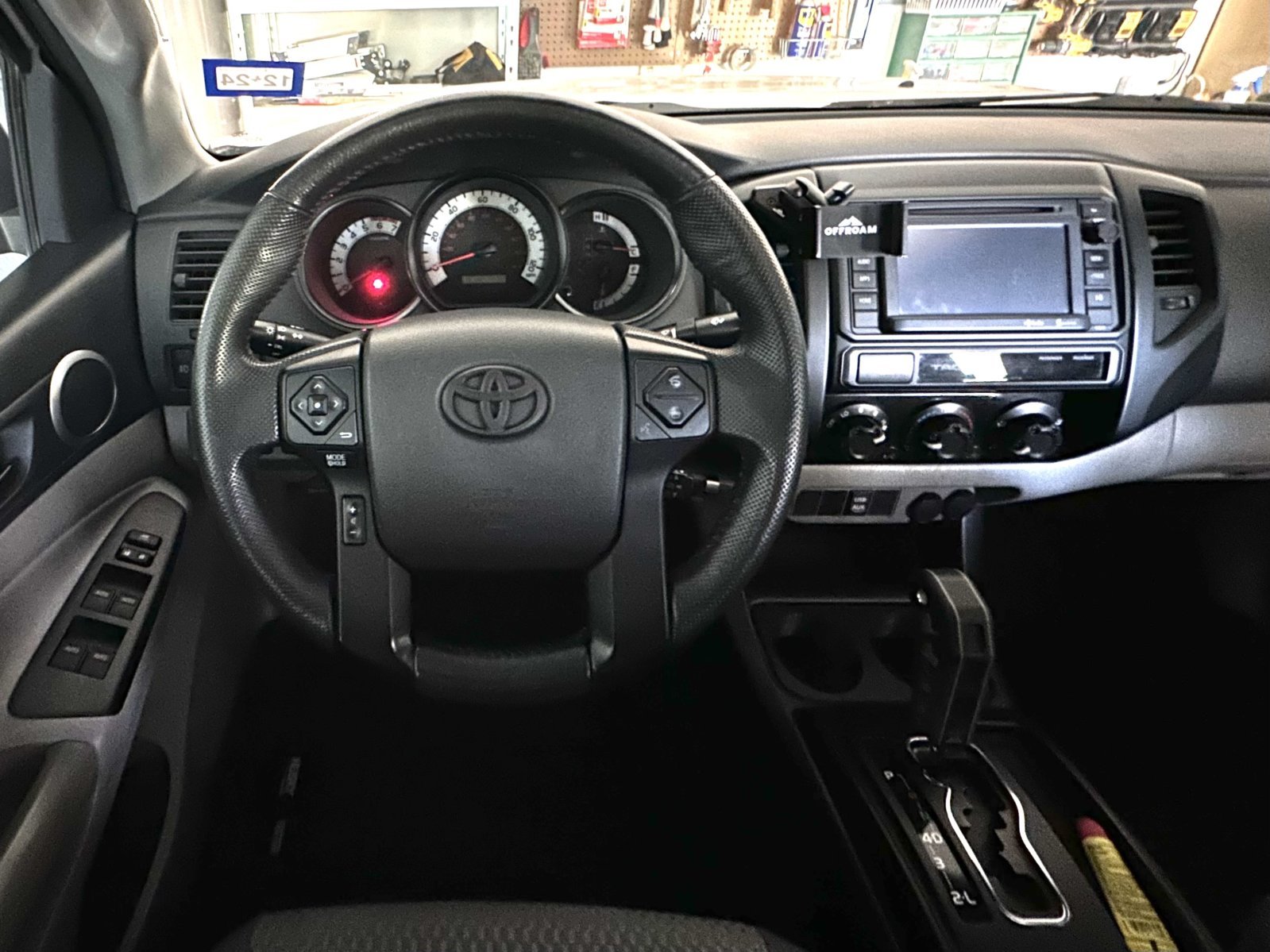

    Here the dash, center console, radio bezel, ac bezel, gauge trims, steering controls. All OE parts. IMG_2021.jpg

    It's extremely durable,and a 1000x better than any other paint.
    You can but Prevail disposable sprayers $7 at home depot and do it yourself.
