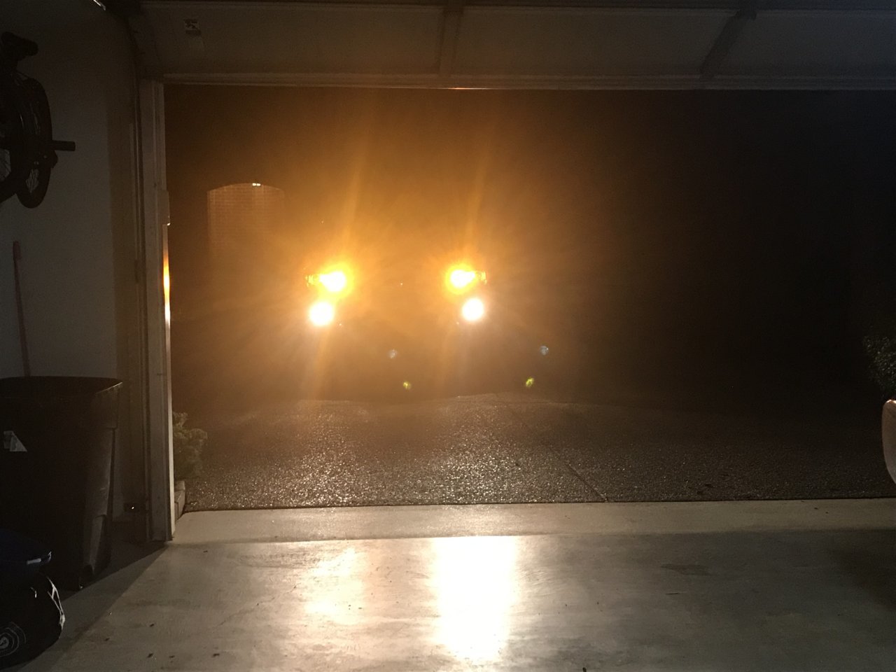

    What is cool is when I put it on auto now my DRL and fogs come on at the same time

    Yeah that’s pretty cool to have those two on at the same time

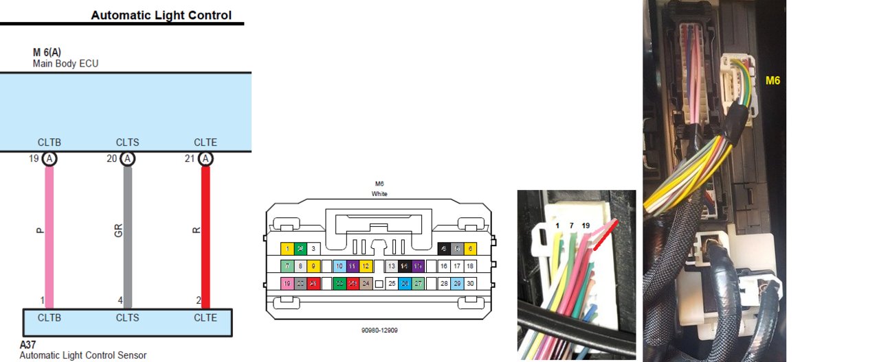

    Check Connector M6 on the Main Body ECU for the 3 wires...

    OP, remove the cubby on left of the steering and take a pic of the M6 connector...

    You got auto headlights to work?
  16. Jan 30, 2020 at 7:27 PM
    #16
    Jgonzalesjr
    Jgonzalesjr [OP] Member
    Jan 25, 2020
    #317196
    22
    2018 SR TSS
    No that’s just the DRL and fog lights
