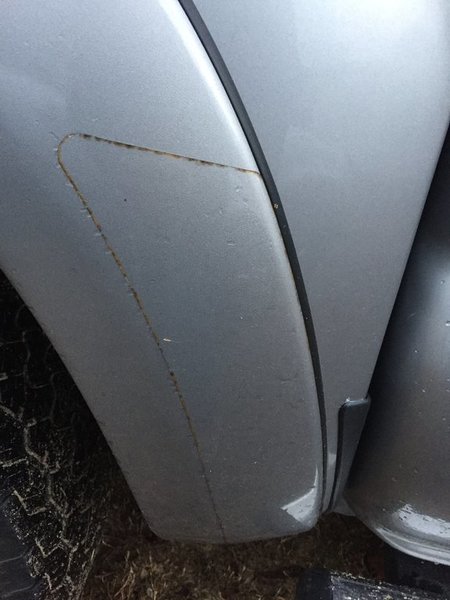

    Cant get it clean, Its got to go! Can anyone show me how?

    Heat gun used sparingly and gently pull the protective film off. Clean gunk off with adhesive cleaner.

    ^^^This
    Hair dryer will work too. Going to be taking mine off soon also. They look like shit on a white truck.

    Crazy to see on a 2 year old truck.
    I have no signs of this.
    Is it mildew underneath a lifted edge of that protection film? Dirt?

    My truck has them on the hood ,behind the door handle, on the doors. An auto shop said 500$ to remove them. I laughed and walked away.

    Common in areas where mildew is common

    Think of the paint chips you'll get to experience after you remove that film.
