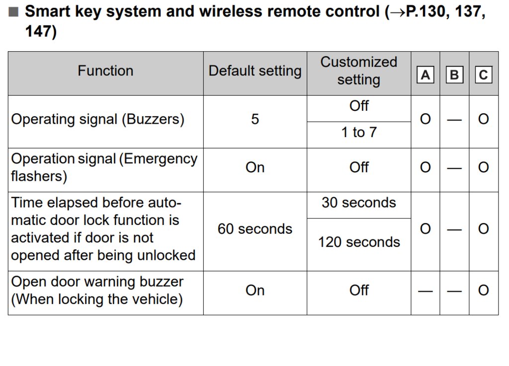

    Have you tried the changing / turning off / the - Operating Signal Buzzers

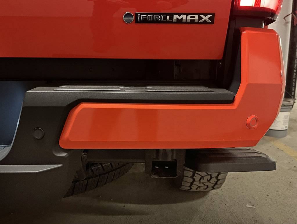

    I moved a "gigantic" piece of furniture the other day. A whopping six feet long! :rolleyes:
    So obviously the tailgate was down. Multiple annoying beeps and buzzers while in reverse.
    Forkin' embarrassing.
    Help me before i pull out my sidecutters! haha

    As for the external speaker-
    When looking to see how to mount my ordered Rough Country rear recovery hooks I saw a speaker mounted on the rear most crossmember (the one that is home to the hitch receiver). It is on the passenger side by the frame rail.
    edit: mine is a Hybrid, so this speaker might be for the mandatory sound when the engine is off, but the vehicle is in motion

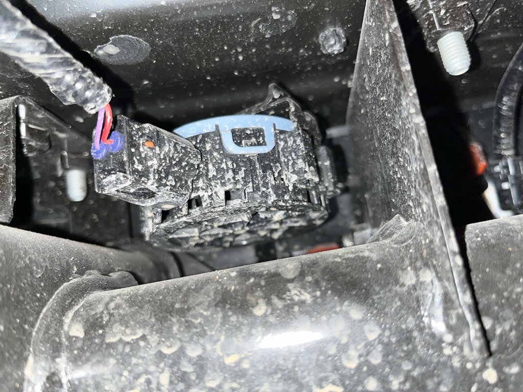

    You can disconnect the speaker, it’s under the drivers wheel well. Undo the flap and listen for the beeps.
  8. Jan 20, 2025 at 9:59 PM

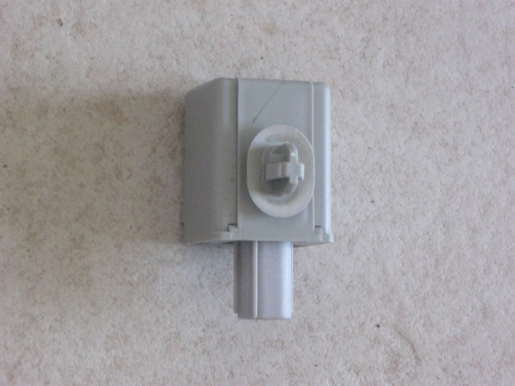

    I'll get a photo tomorrow. The speaker looks like the mandatory back up alarm speaker i have seen on heavy equipment.

  11. Jan 29, 2025 at 11:20 AM
    max911
    max911 Active Member
    Sep 19, 2024
    #457313
    40
    max
    Alberta
    2024 Tacoma TRD Off-Road Hybrid
    (second photo is laying under the truck with the camera facing rearwards)
    It is mounted above the rear cross member where the cross member is welded to the frame rail.
    In other words, just towards the center of the truck from the passenger side jack point.

    OMG totally agree! It's the back seat reminder beeps that drive me nuts. Lock the truck and it beeps 9 times to let you know there's someting on the back seat. No shit. That's why I locked the truck. So nobody grabs my packouts or any of the other junk I intentionally left on the back seat. It beeps if I turn off the truck at the gas station if my dog is on the back seat. Beep beep beep! Love the truck but it beeps like an anxious grandma. Everyone keeps saying there's a menu setting to turn off the beeps but damn if I can find it.
  14. Jan 31, 2025 at 2:10 PM
    thefinalstraw
    thefinalstraw Well-Known Member
    Aug 13, 2015
    #161671
    707
    2024 Underground TRD Sport 4x4 Premium
    check the owner's manual...
    OpeCity likes this.
  15. Jan 31, 2025 at 2:23 PM
    OpeCity
    OpeCity Well-Known Member
    Feb 28, 2021
    #357705
    3,280
    Long Beach, CA
    99, 24
    Legit the first thing I changed in the settings :rofl:

    Found that MF! Like Tex said, undo the lower part of the drivers wheel well fuzzy, and look for this:IMG_2666.jpg

    Thanks buddy, found it today, disconnecting it works like a charm.
    Further info that may help somebody else: You can simply undo two 10mm screws that attach both the black fuzzy material and the plastic front spoiler on the underside of the vehicle. Reach up with some pliers and pull the connector loose.
