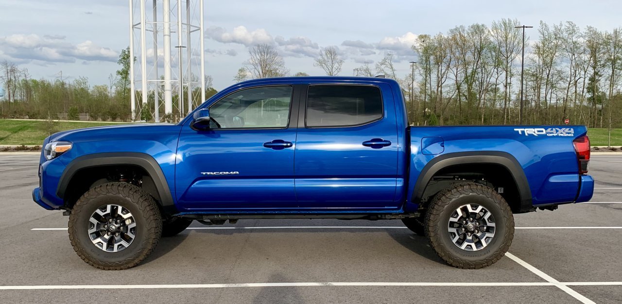

    I do and it's great, absolutely no issues.

    I have a 2" spacer in front and 1" block in the rear.

    Its super simple. I have the Rough Country 2" spacer in the front and a tapered 1" block in the rear from Amazon. Seeing as the spring rates are not changed at all, the ride is literally exactly like it is stock. The E rated KO2s made the ride slightly more stiff. I'm 100% happy with it.

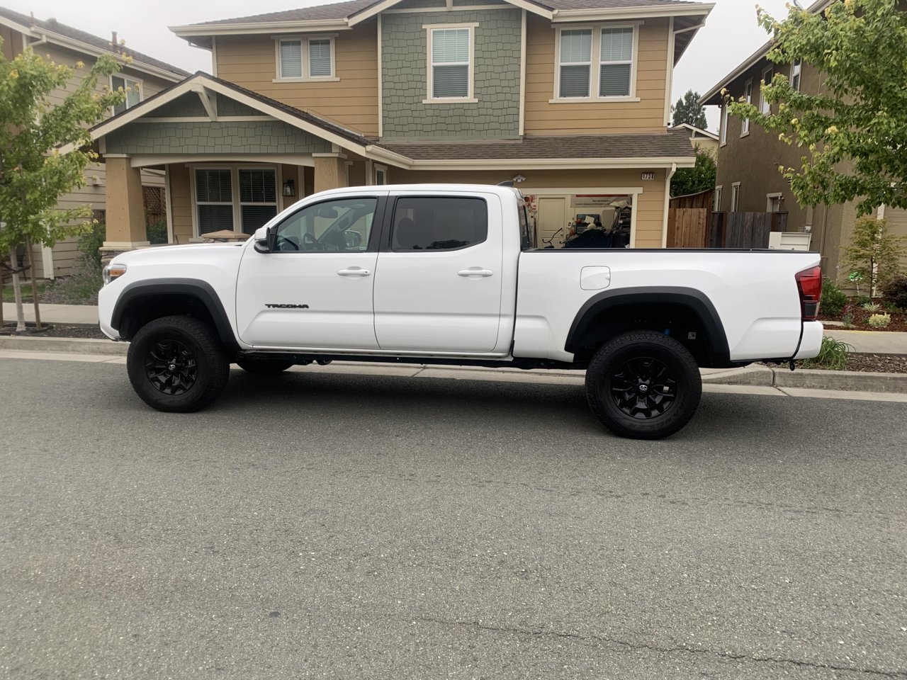

    10 k miles on lift no problems at all. Camping and light trails for me. Go for it IMO. Nothing wrong with spacer lifts as long as you don’t plan on any heavy off-roading. Base your decision on what’s meets your needs. Personally if I was off-roading a lot I would’ve spent a lot on expensive set up. I don’t. So I went with a spacer lift. Researched a lot. Diff drop shims etc. lift is great ride is just fine. No problems. Also don’t listen to all the shit talking on here about spacer lifts. People talk shit about everything on here. Ruins the whole positive vibes on how we are all excited about what we are doing to our trucks. Good luck
