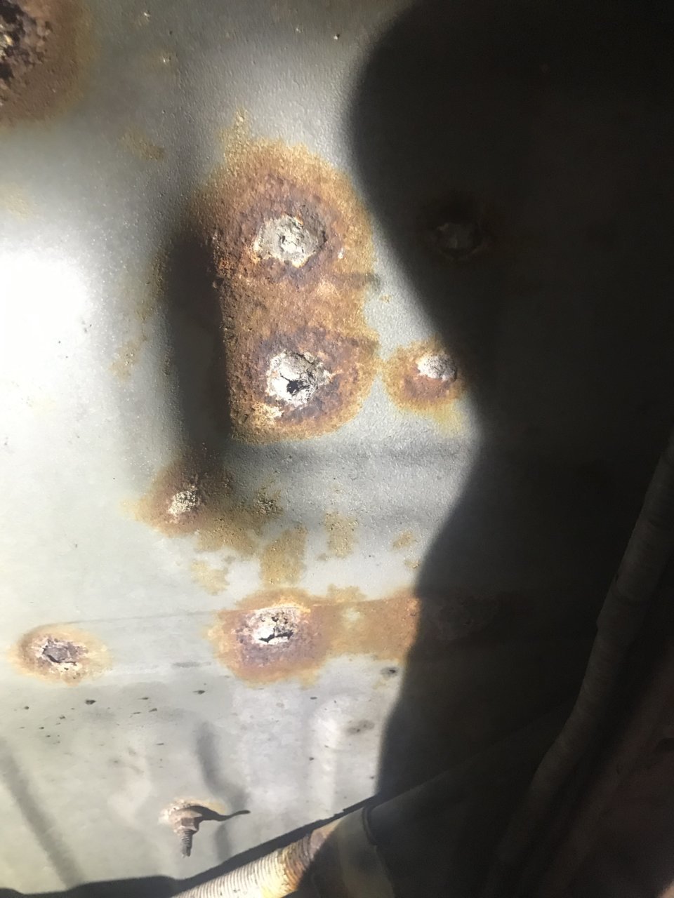

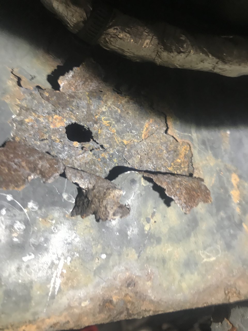

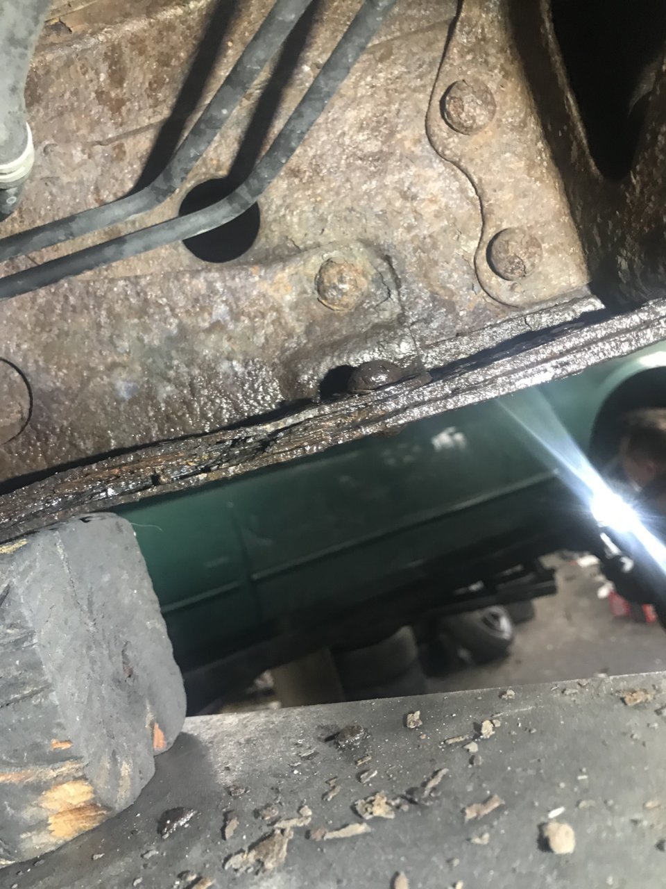

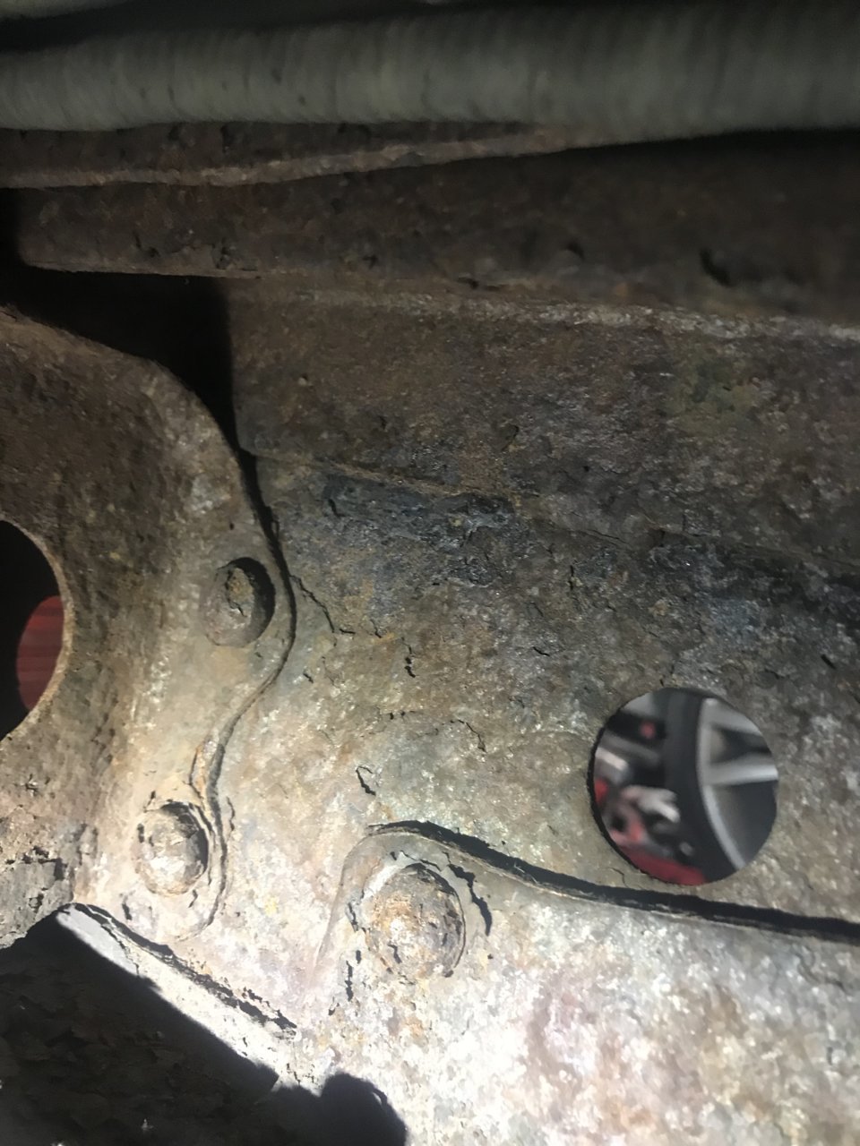

  17. Jan 13, 2019 at 1:44 PM
    #37
    george101
    george101 [OP] Well-Known Member
    Dec 7, 2016
    #204270
    241
    Georgie
    Los Angeles Co.
    2006 tacoma trd off road
    non
    Well, I tried. I accidentally put up duplicates.
    The under bed of the back end of the truck, is #1 and #4

  19. Jan 13, 2019 at 2:31 PM
    #39
    Jeffch
    Jeffch Well-Known Member
    Dec 23, 2011
    #69251
    3,243
    Jeff
    Vermont
    2018 off road
    Running 285/75/16s
    Yea second and second to last pic in first post w/pics is a fail.
    Doesn’t look malicious you should be fine. Again remember they may not let you leave with it.
  20. Jan 13, 2019 at 2:35 PM
    #40
    george101
    Dec 7, 2016
    #204270
    241
    Georgie
    Los Angeles Co.
    non
    Wow, thank you. Are those the rails, in the second to last pic?
