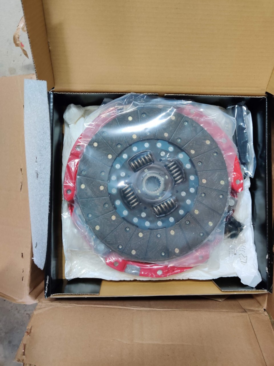

    9,869
    the MT folks here understand what the accumulator does. Trident is one of the guys waking up the delete mod the 3rd gen guys often use. and by the way it's not hard to understand. o_O
    if you do the ADM (the delete mod) then you will be more in touch with your clutch, it's bite, it's slip, and it's release. getting all this in my hand to drive the vehicle well is the reason i went with the MT.
    oh, and this :DIMG_20190827_184134.jpg IMG_20190827_184146__01.jpg ..
