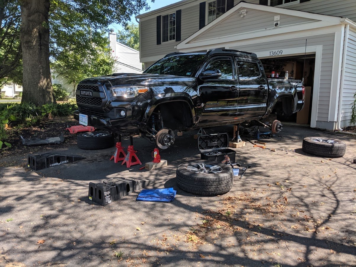

    Are you still rocking the factory suspension, wheels and tires?

    OME lift, 3leaf AAL, uniball UCAs, 3° shims, CV bushing, U-bolt flip + Superbumps, sway bar relocate, Cooper Discoverer AT3 XLT 33s, cosmetics
    OME shocks and coils, 3 leaf AAL, 3° shims, U-bolt flip with superbumps, poly bushings all around, driveline drop, sway bar relocate, UCAs, CV axle needle bearing clamshell replacement, Cooper Discoverer 285/70/17 AT3 XLTs. All done by me, in my driveway, alone...except tires obviously.
    IMG_20191016_082317.jpg IMG_20190910_190750.jpg IMG_20190907_124453.jpg IMG_20190908_115827.jpg IMG_20190914_130719.jpg IMG_20190913_152613.jpg
