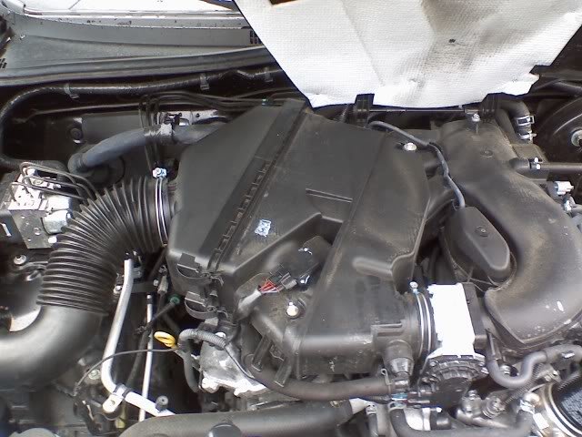

    Ok I looked and there are two of those clamps that requires a phillips head to undo. There is one next to the hose right where the filters are then there is also another one in the middle.[​IMG]
    Is the MAF sensor that in the lower left where the wires are?
    [​IMG][​IMG]

    no pics came up man.

    Does it show up now?

    the maf is right there near the front where the wires are. unsnap the clip, and it'll unplug. the hose on the front......you can just pull the whole end outta the intake, and it goes back in easy.

    hey man, can you circle the bolts that he needs to remove also?? im not sure as to how to put up pics with circles.

    yep.....what 007 posted was for the 4cyl.
