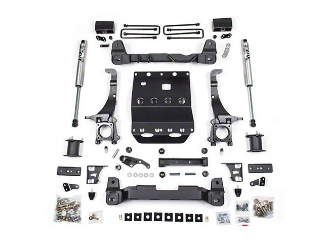

    So I'll start off by saying, I was not a proponent of the "buy once, cry once" ideology. I have a 2018 Off-Road, and went with a BDS 4" lift kit and 33x11.50 tires.
    the BDS suspension has differential relocation brackets, sway bar relocation and new crossmembers.

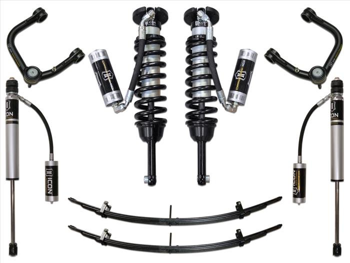

    but I have come to the conclusion that a spacer lift and 4" just isn't the best way to go. And I am strongly considering possibly swapping this out with an Icon Stage 4.
    just curious if anyone has done anything dramatic, like going from one lift to another, and if it was worth doing or problematic?

    There are coil-overs, shocks and leaf springs made that will marry up with your current kit. Not cheap, but cheaper then undoing the current setup and buying the icon set you posted. @AccuTune Offroad has this kit https://accutuneoffroad.com/product/kit-05-tacoma-fox-2-5-factory-race-series-shocks-dsc-4-6-lift/ but they may have others that will work, hit them up for what options you have.

    Why do you want to get rid of the spacers? AFAIK, the spacers on the front of a drop bracket lift do not cause any issues and there is no better solution. A drop bracket lift basically drops the entire IFS downwards and otherwise leaves its geometry intact with the exception of the spindle length. In any case, I believe Fox makes coliovers for 4-6" drop bracket lifts that remove the need for a spacer. I'm not sure you are gaining much thiough, as any extra uptravel in the shocks will be limited by your extended bumpstops.
