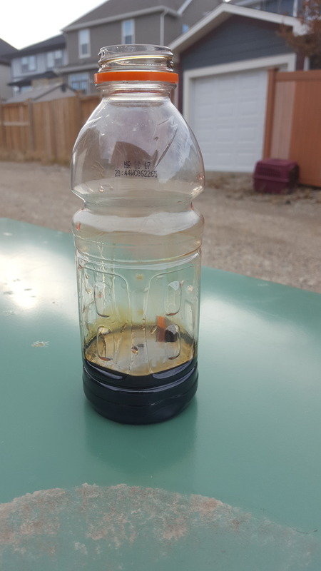

    Im definitely going to be installing a catch can on my Tacoma after my experience with my ISF (also DI and PI), even though the ISF had extensive R&D done on blow by management my custom setup still managed to catch probably around 100-150ml of something whether it was oil, water or blowby acids?
    This picture was after I emptied most of it via windex spray trigger 6 months down the road. I also attached the PDF of the blowby system features.

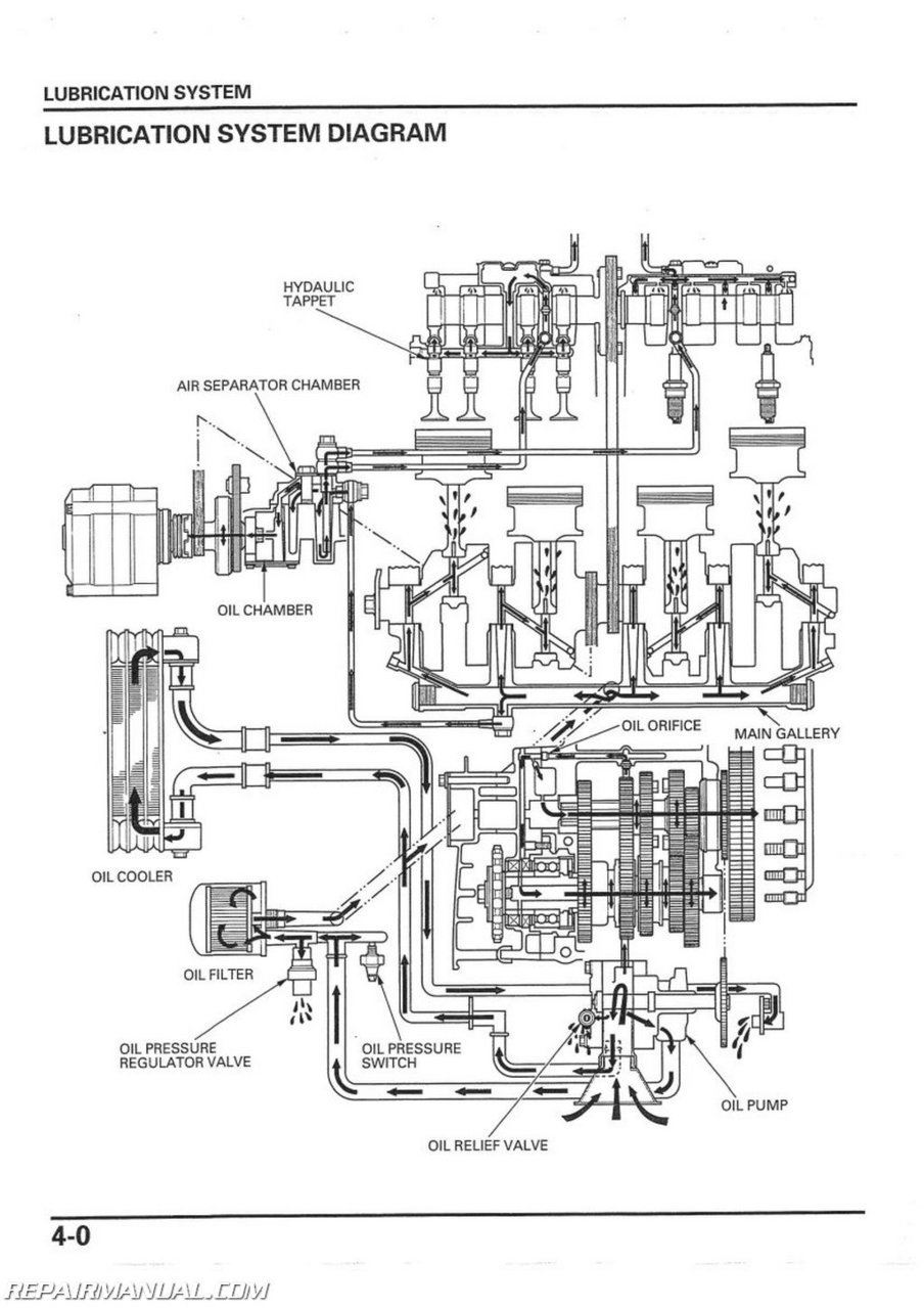

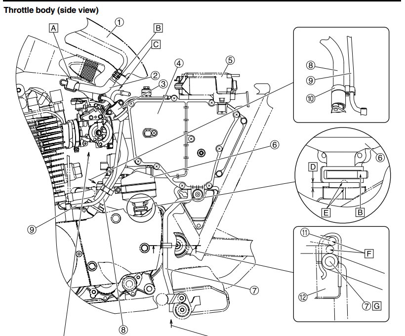

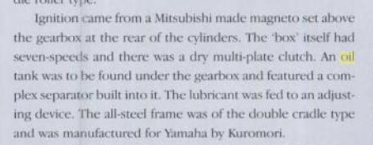

    Thank you for wording you question the way you did. To be honest I don't know a lot about motorcycle engines and as I am an automotive mechanic. The oil separators on motorcycles are called different things by the manufacturer so we can't use the words "catch can". To have an intelligent conversation I think we can agree to say that a catch can is some type of oil separator. OK good.
    Here is a Honda 750 engine. You can see there is an air chamber separator. Don't ask me how this thing works as I really don't know, but Honda thought it was necessary. If I was to make an educated argument I would say that because bikes rev so high and fling oil like crazy inside (don't forget the transmission and engine oil is the same) they create a lot of mist, much more that a car or truck?

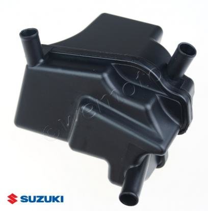

    This is one off a Suzuki
    This write up is about Yamaha
    ref:https://books.google.ca/books?id=fp...anese motorcycles have oil separators&f=false
    https://www.psychobike.com/forums/suzuki-hayabusa/127153-return-oil-tank.html
    see post#2
    its just a tank/ bottle that catches the excess oil that blows out of the crank case. The oil will drain back into the case (Refers to GIXXER)
    http://www.chopcult.com/forum/showthread.php?t=15598
    post#2
    Triumph oil tank is engineered with some special return flow characteristics needed for proper rocker oil feed supply and specific breathing designs that separate the air from the oil, it is not just a container with oil in it.
    Here is a Yamaha engine below. #6 is the oil separator.
    I should note all these oil separators or catch cans on motorcycles are designed to drain back into the engine so they are maintenance free.

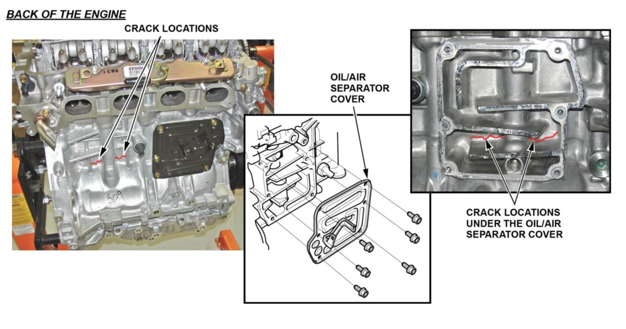

    I guess the Honda Civic has a factory oil separator on it. It is also maintenance free.Screen Shot 2019-10-08 at 7.45.51 PM.jpg
    We know the Hellcat has a factory separator in the valve covers, GM has a separate unit on the Camaro, Audi has them on top of their TFSI, same with VW so they are around. They are all maintenance free and drain back into the engine. I am seeing a trend here and that is maintenance free. We must keep in mind that maintenance is a huge thought for manufacturers and thats probably why we don't see the external aftermarket ones we talk about. If you don't drain it you can damage your engine and I believe thats why they are not installed from the factory (too much liability for user error). Each manufacture has their own way of doing things and some work better than others.

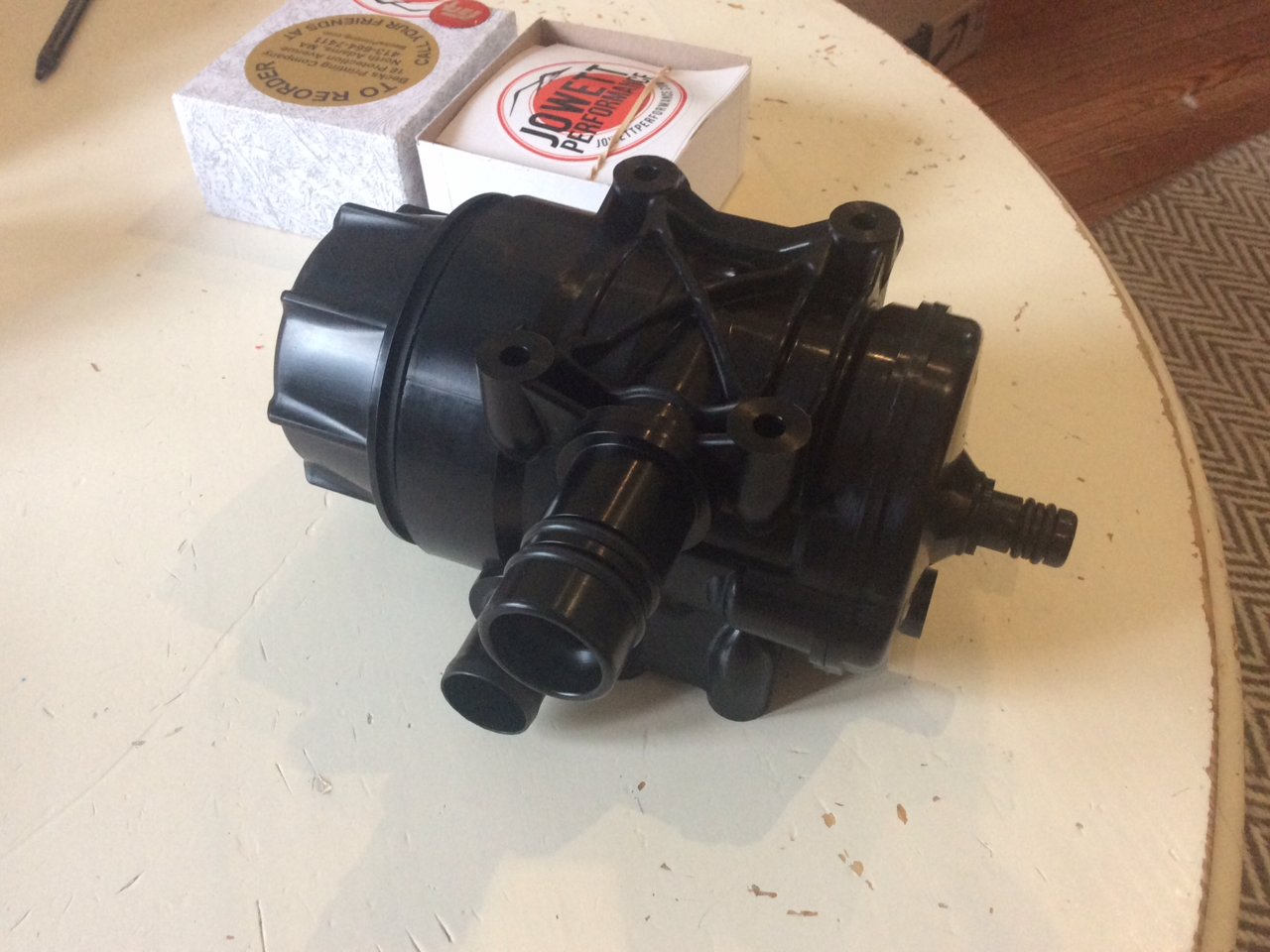

    Here is the factory Toyota/Hino separator that was utilized on some of their Diesel engines. Later models receive a unit that is built into the cylinder head cover. It has a nice large capacity depth filter and can drain back to the sump if desired. Cheap and required insurance.
