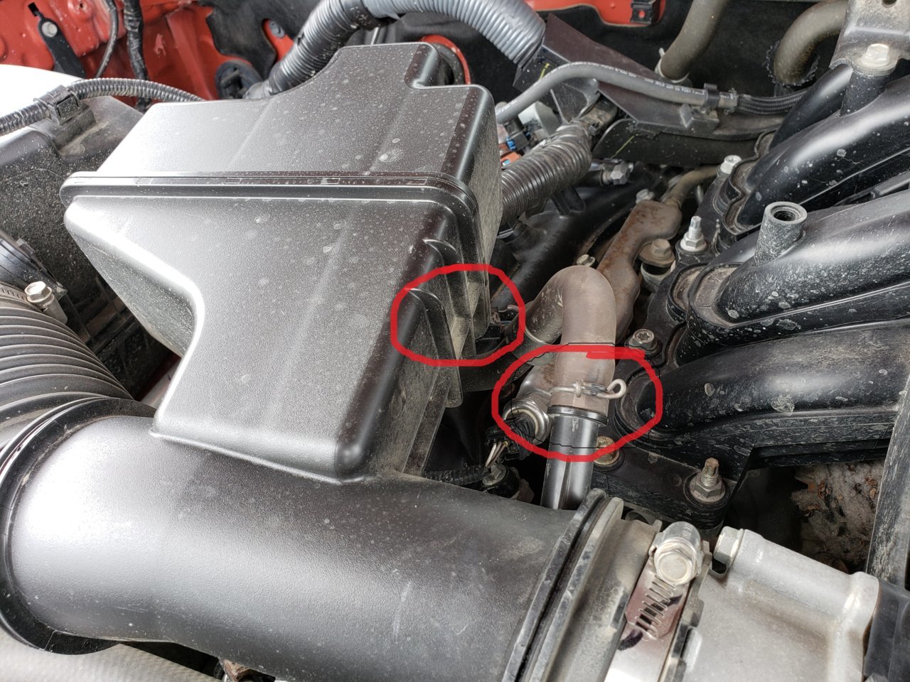

    Three years old, 35k miles, my truck. Never had the intake tube off, always replaced the air filter with OEM at 12k.
    This oil left a trail into the throttle body and tb flapper.
    This is the residual stuff that a proper catch can will collect before it goes into the intake and the throttle body.

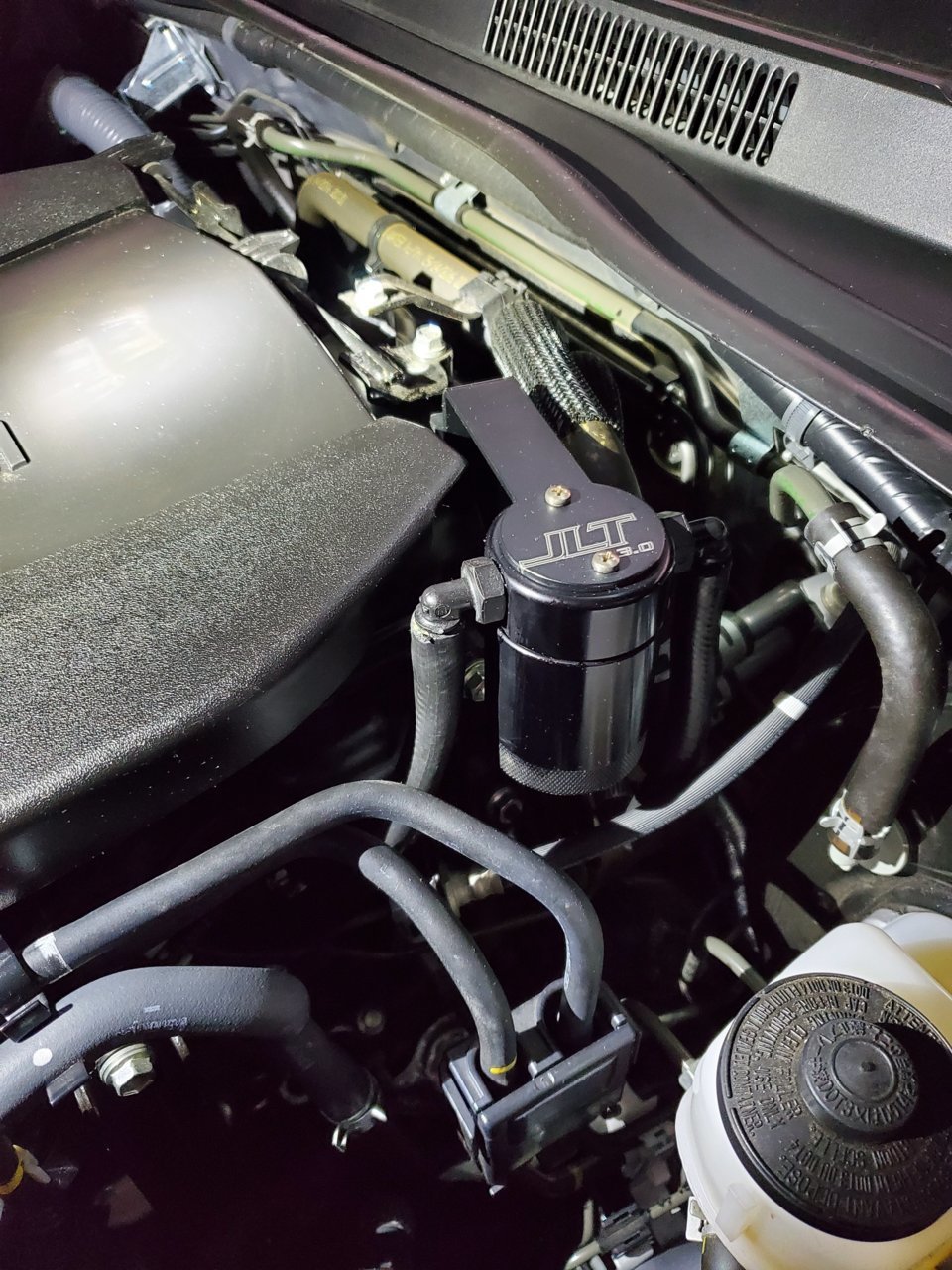

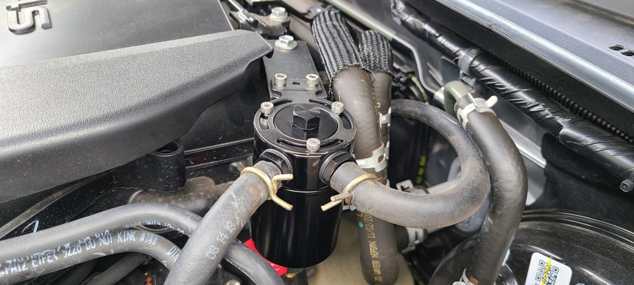

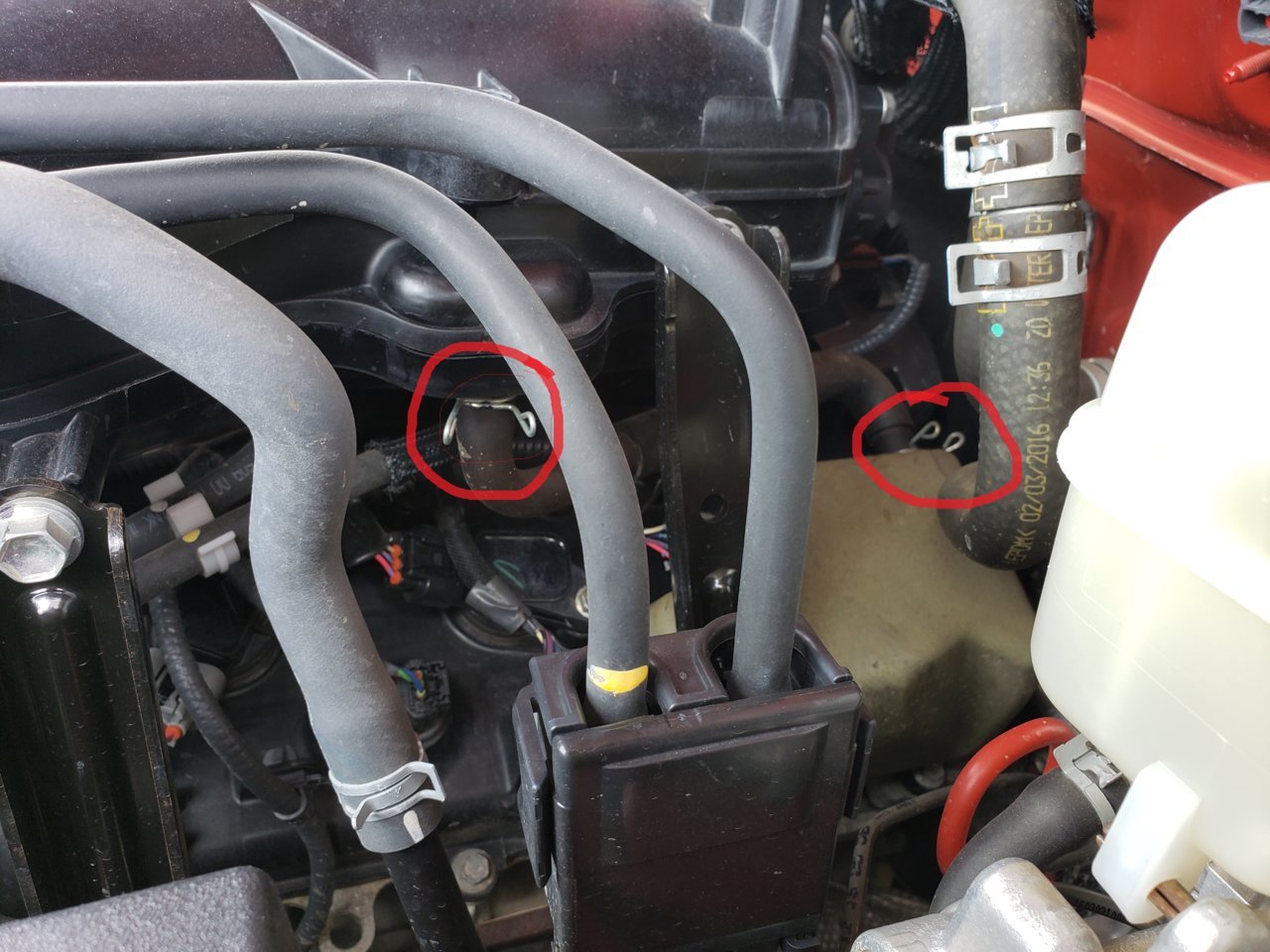

    Could I get some words to go along with these pics please? I'm getting ready to install one of these and need to know how and where the hoses hook up. I think these pics might answer my question but I'd rather be sure. Thanks. :bananadead:

    Earlier this year I did for some reason.
    Rottencotton likes this.

    Thanks. Which is in and which is out?

    https://www.jlttruecoldair.com/content/3104D.pdf

    I'm not using a JLT can so "J side" and "T side" don't mean anything. My can is marked "In" and "Out". And it didn't come with instructions. :bananadead:

    If you have oil there pre throttle body, you have bigger problems. Air flows INTO that hole as the air pressure is higher pre throttle body vs post. About the only thing i could think of that would cause oil there is simply some oil vapors rising up the breather tube when the hot motor is shut down.
    Needless to say a catch can wont stop oil from collecting there... thats not even the tube you would be putting it on.

    The blow-by travels from the valve cover into the can, gets filtered and out of the can into the intake manifold. If you use the JLT instructions as reference the “T” should be your “In” and the “J” should be your “Out”. Unless whoever made your can didn’t intend those markings to be the direction of the gases.

    Answers my question. Thanks. :thumbsup:
