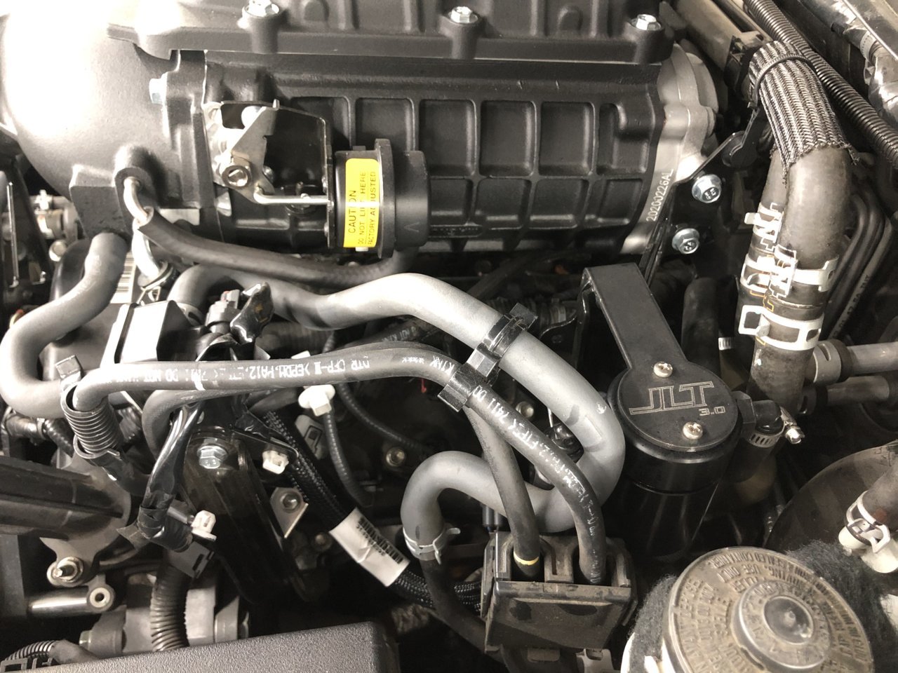

    I had to modify the bracket by cutting it and drilling a 1/2” hole to mount on the supercharger bracket. Jlt existing mounting on the intake manifold is no longer there. Stock hose from pcv fit perfect to one side without cutting. Magnuson provided hose fit on the other side. So far one tank of gas and it’s working.

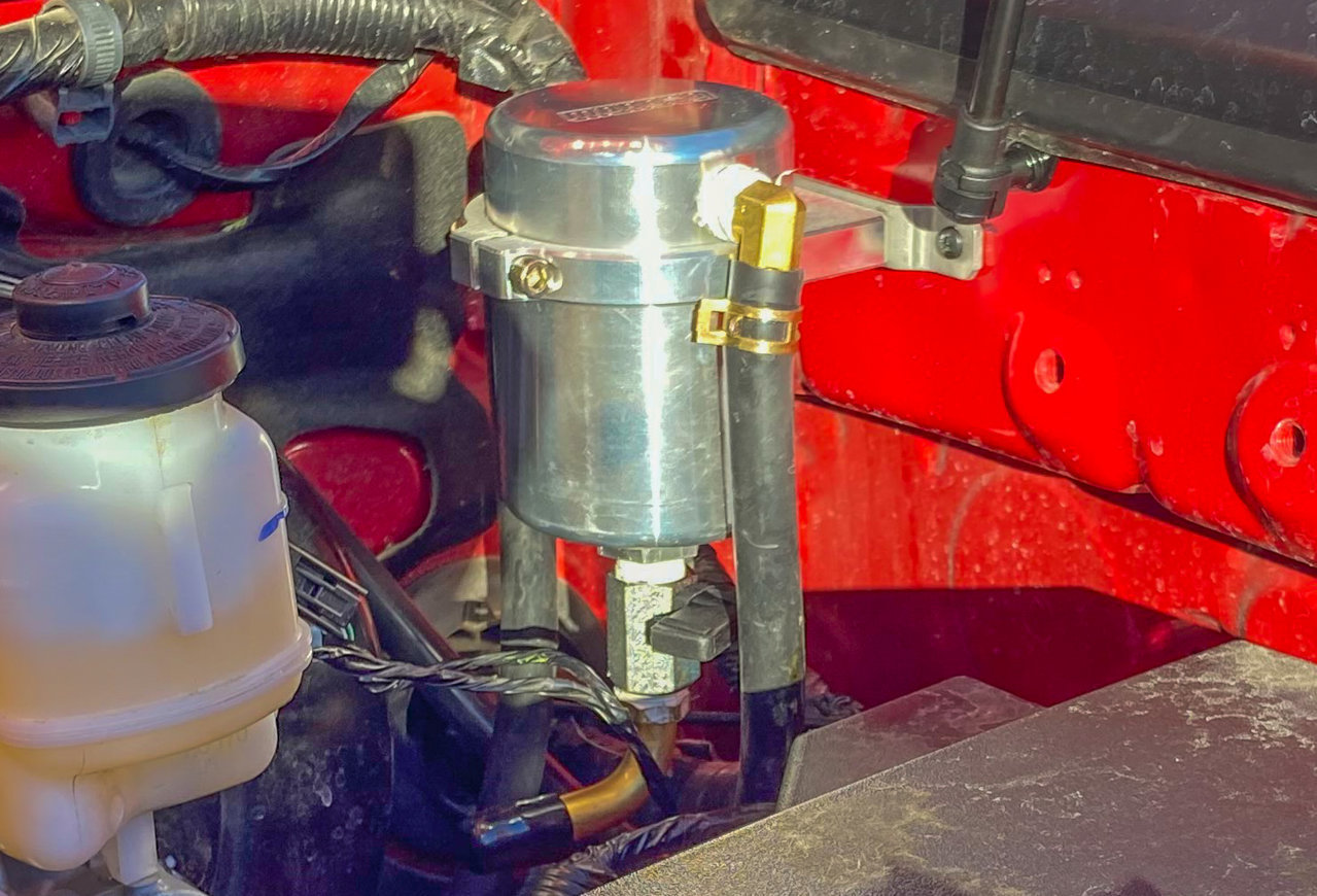

    Mine has been mounted on the pax side for over 35k miles with no issues. 8-10ozs in that time.

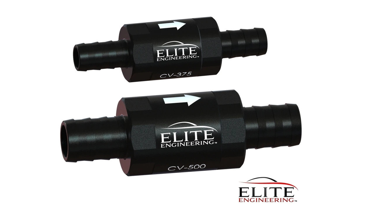

    So I have been discussing this with my cousin, a Ford master tech(Drives a Camaro SS, installed catch can since day 1, go figure) who advised he placed a one way check valve on the catch can line to "avoid potential backfire issues". The catch can does catch fuel and a backfire might ignite it according to him, but I'm not sure if there would be enough O2 to facilitate the kaboom or if anyone has ever experienced something like this. What do you all think? Unnecessary or a decent preventative measure than can't hurt?
