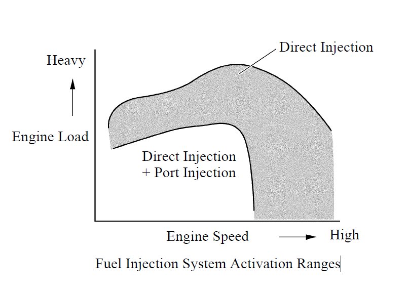

    Also from the engine manual
    xxTacocaTxx likes this.

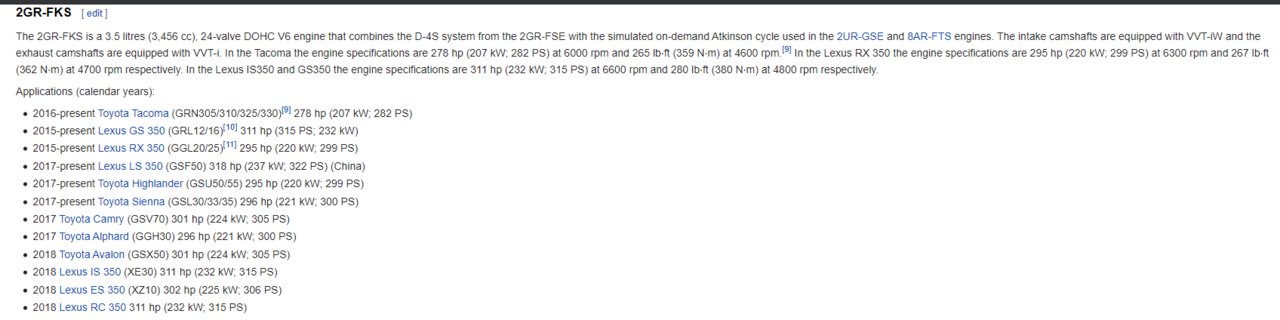

    Where are you getting that from?
    The 2GR-FSE/FKS is one of the most proven, reliable engines ever made.
    https://www.wardsauto.com/technology/toyota-advances-d4s-self-cleaning-feature-tacoma
    https://www.wardsauto.com/news-analysis/toyotas-twofold-strategy
