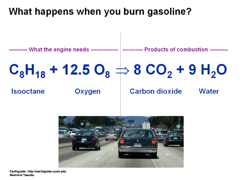

    Love It!!!!! In a perfect world
    In the real world all you have to add to your equation is unburnt oil on the input side!!!!

    The point was that you don't have to have a leak to get condensation inside your engine.
