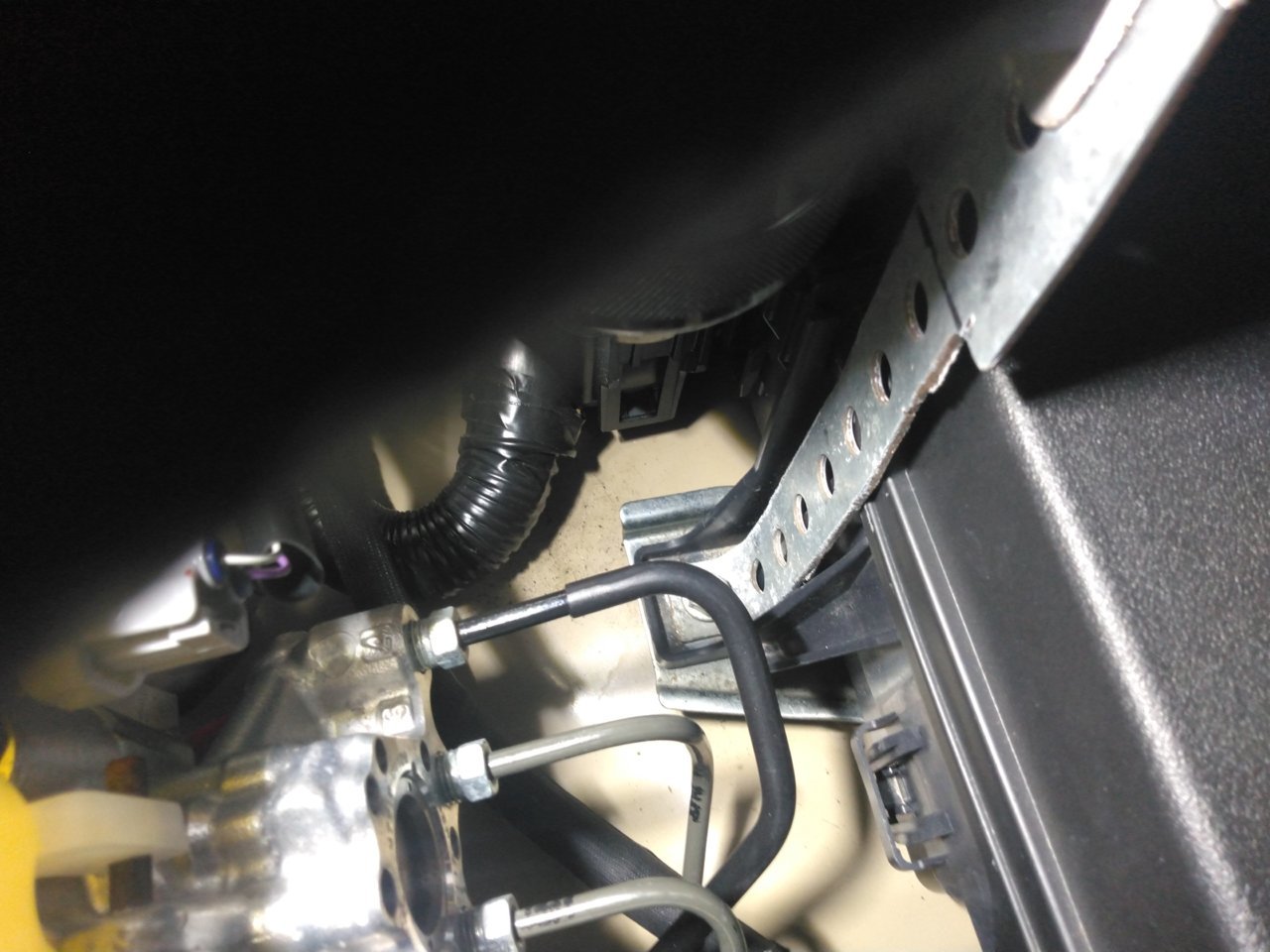

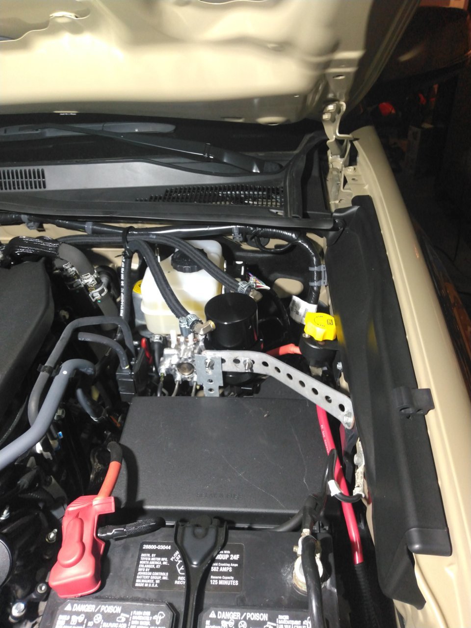

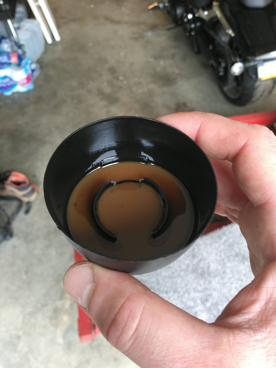

  15. Oct 7, 2019 at 7:01 PM
    #175
    MDFM31
    MDFM31 Well-Known Member
    Oct 15, 2010
    #44696
    1,237
    Chester Co, PA
    16 DCSBOR
    Hopefully someone will stumble across this and find it useful-
    I used a universal catch can and mount from UPR on my 2016 and mounted it with some light gauge steel from Lowe's. It's not pretty, but I did not want to drill any new holes or move my winch cut off switch. I would not expect performance gains out of a catch can, but it could increase engine longevity. I thought it was worth the $100 or so. The stuff that it catches is gross.
