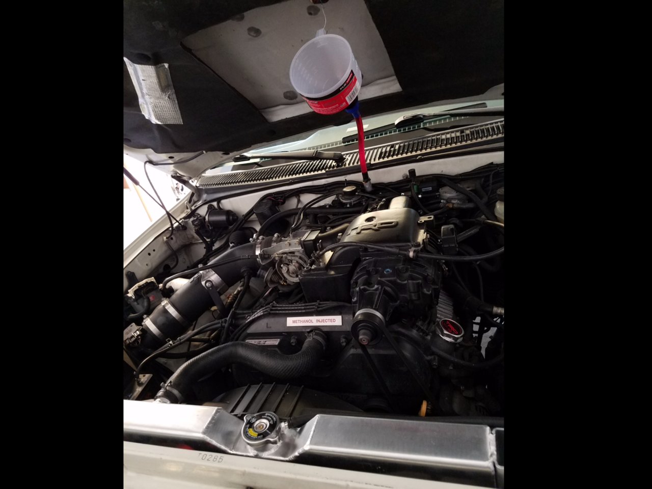

    On the 1st gen 3.4, I let it run with the heater valve opened up and the front of the truck jacked up. Air bubbles out into the big funnel.
    cruiserguy likes this.

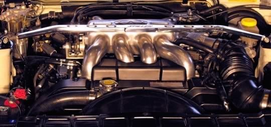

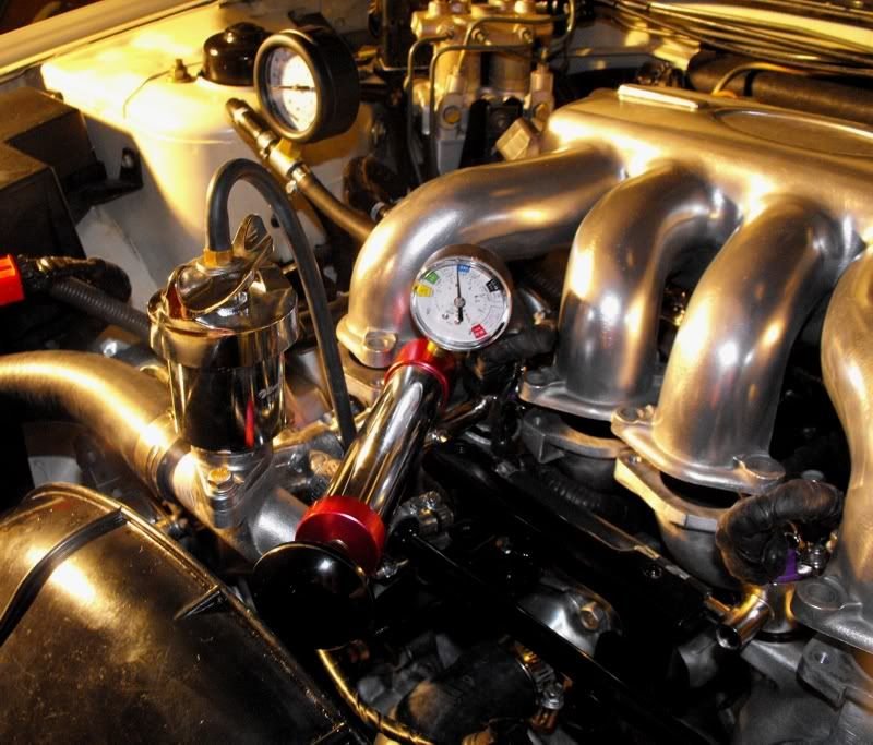

    Have you guys ever seen a car with two radiator caps?
    One cap off the engine cooling line above the water pump
    The other cap on the radiator.
    1997tacomav6 likes this.

    I actually like this process because you know for sure all the air is out from the higher location and cost was 8.00 for the valve and funnel.
    Filled the front section from the radiator cap 1st then the back
    And an old magnet on the hood to hang the funnel in place
    I might look for a metal valve tho
