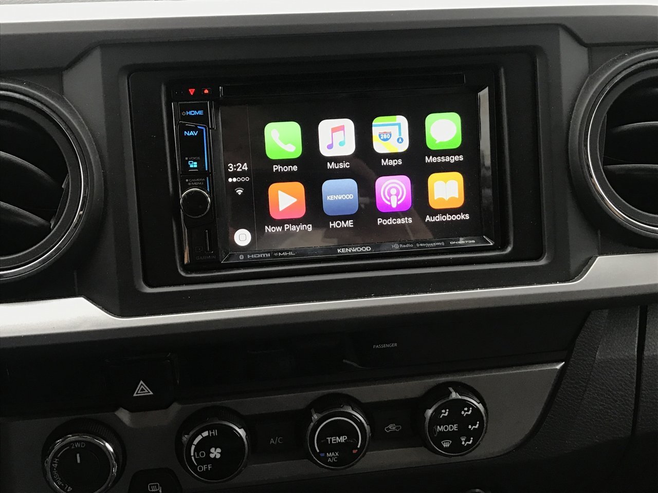

    I put a Kenwood in my 16 SR5:
    I didn’t think the install was any more difficult than others I’ve done. Just more connections. You’ll need an interface module like the iDatalink Mastero. Crutchfeild has good info.

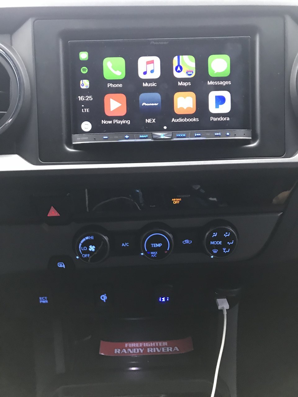

    Ive done about 10 at my business
    Heres my personal, Pioneer avh-8201NEX

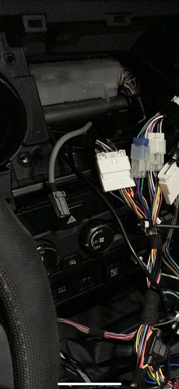

    5D93E29E-13CE-4215-9B54-8FA12DEA5472.jpg I just installed a Pioneer 1500 nex in my 19, got the maestro hooked up, every thing on the wheel works. The only thing I’m missing is the backup camera, there’s a gray wire, has a funny shaped connector and I think I need an adapter for it to go to an rca? Crutchfield didn’t say anything about it, I’m curious as to what y’all have done? Or am I in the wrong ballpark with that gray wire?

    That gray wire is the USB. The mastro will have a RCA output for the camera unless you got only the basic SW module. That module doesn’t retain the backup camera. You will need a different module and harness.
