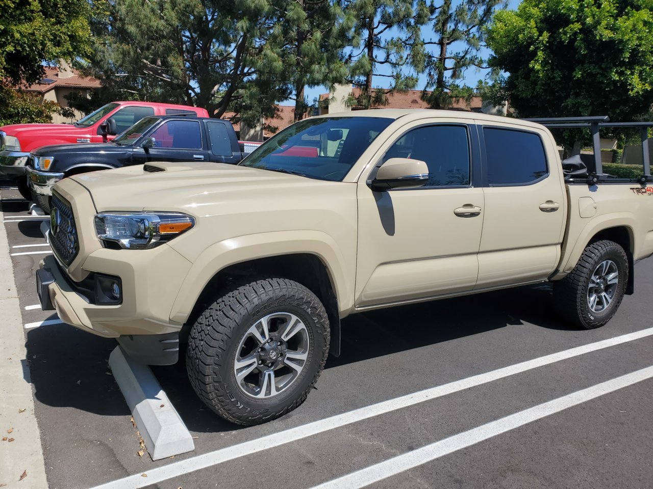

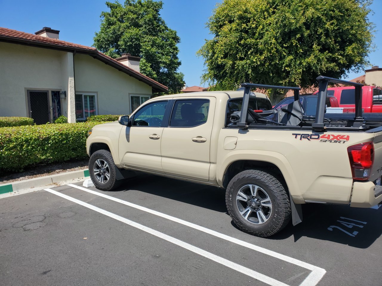

    Here's my 2 cents..... I have a 2019 Tacoma Sport 4x4 DCSB. The stock Hitachi shocks( didn't even know they existed before this truck) are complete garbage. LIKE POGOSTICKS. No joke. Makes the truck a bit unsafe in handling bumps and bends in the road.. floats all over the place in my opinion. Felt a bit out of control. I had a dodge ram full size 4x4 before so if anyone has the same experience the Toyota seemed VERY bouncy in comparison... fast forward 1 year and about 14K miles. I just put on Bilstein 5100's all the way around using the STOCK springs.. Mounted the front struts on SECOND RING...( leveled truck). ITS A NEW TRUCK. No more bouncing all over the freeway and now it absolutely absorbs speed bumps and driveways and dips. I should have drove the truck from the dealership( when I bought it) right to my mechanic and had this done a year ago. In my opinion, you are not gonna needs to spend A LOT of money on ICONS or FOX etc to get a wonderful ride. If you want to keep it STOCK-ISH... I found this is awesome. I also have 1.25 Spidertrax wheel spacers and Falken wild peak 3's- 265/72/17. they rubbed a little in certain positions without the small bump of the 5100's.. the rub is gone. Pics included enjoy.. BTW- i paid 349 for the 4 shocks and $310 install because im too lazy to install myself.
