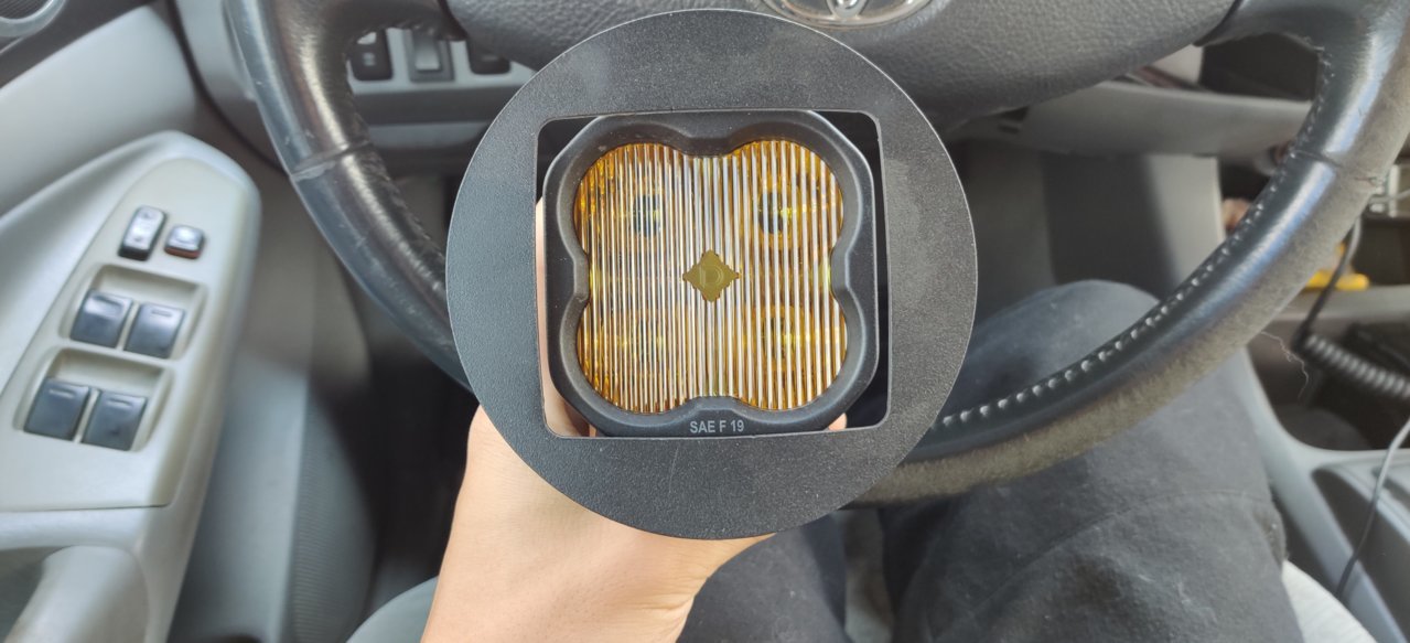

    I modified some brackets from caliraised to fit the ss3 into a 2011. They are currently installed and work great.
    Edit: the round bezel won't fit into the bracket unless you notch the lower portion of the bezel. You will have to swap out for a square bezel.

    Did you have to modify the caliraised brackets at all to do this with the rectangular pods? Hard to tell from the photo angle but it looks like part of the two ribs on the back of the brackets are missing.
