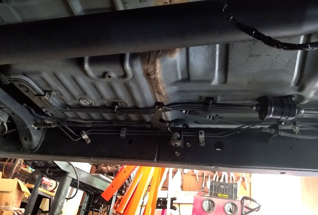

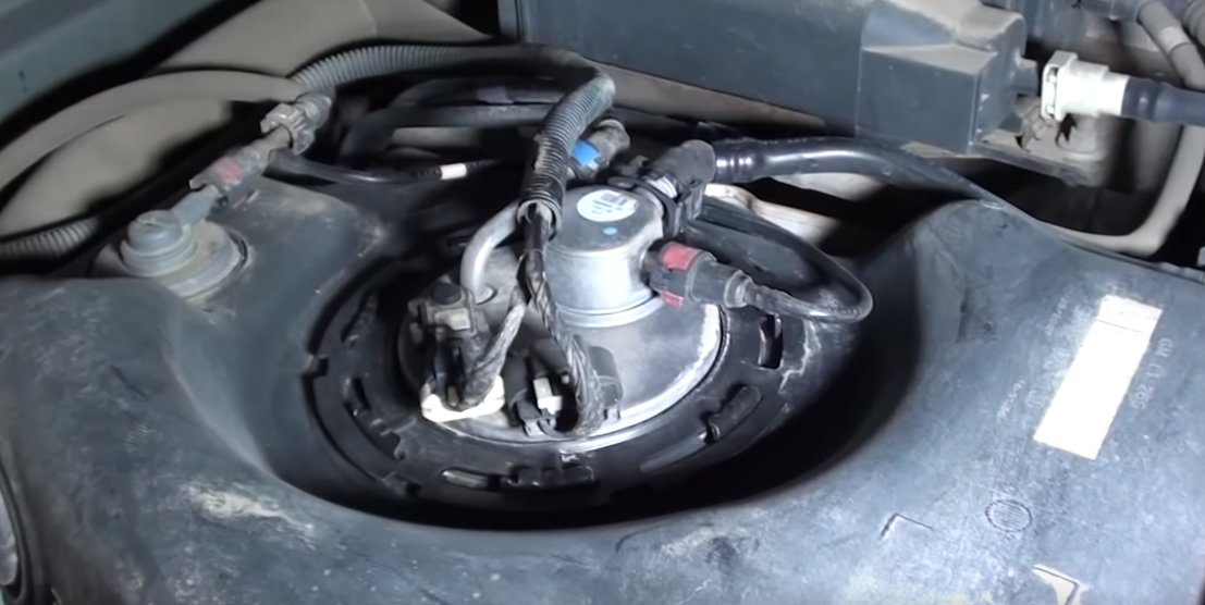

    I've seen pictures of Tacoma beds being lifted from the front to access the fuel pump.
    Has anyone tried to lift the bed from the side instead of the front?
    If I could get to each side of the frame like this, I could reach the fuel pump and the outer side of the frame where I want to do some clean up.

    Not sure if this helps, but I used both methods when I changed the fuel pump on my '94 Ranger. After unbolting the bed and fuel filler neck, I slid it back over top of the wheels and also tilted it toward the passenger side. I had full access and had the pump changed out in 20 minutes.

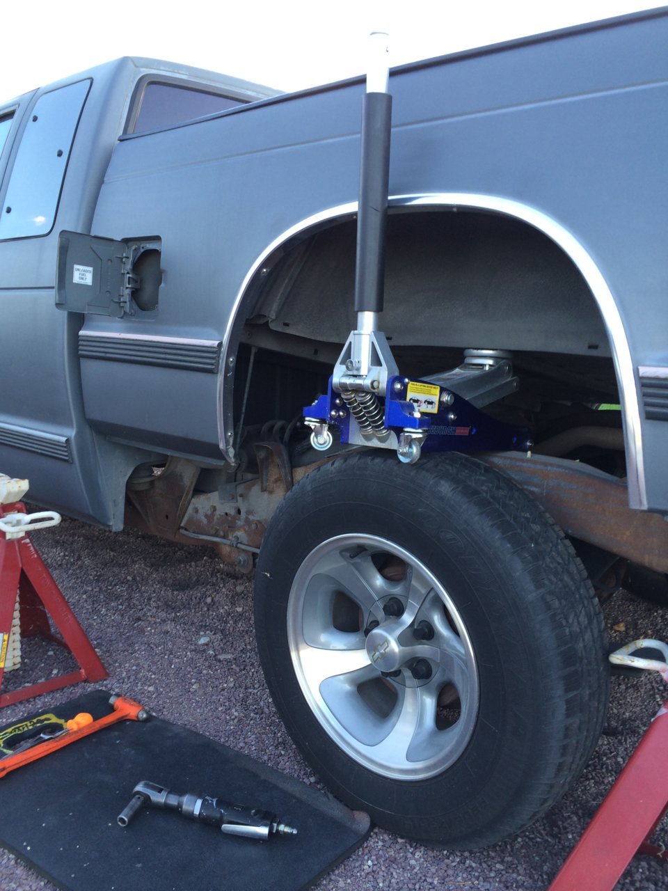

    This is how I did the fuel pump on my S10 a few years ago

    I just used the factory supplied bottle jack and had a second hand to help me lift the bed enough to wedge it between the frame and the bed. The rest was crank and go, easy peasy.

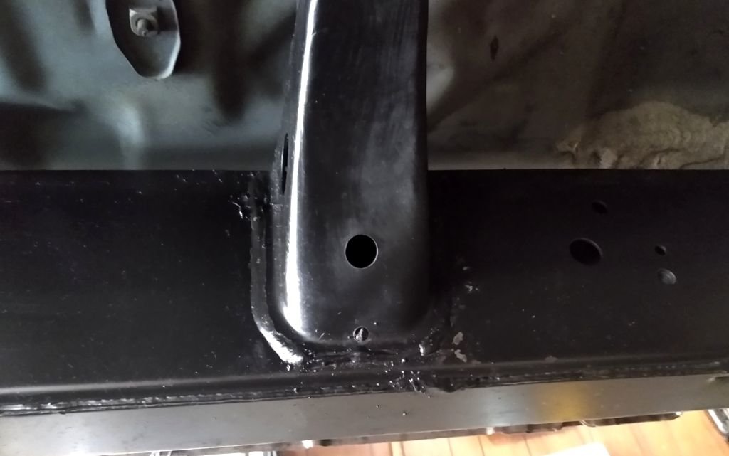

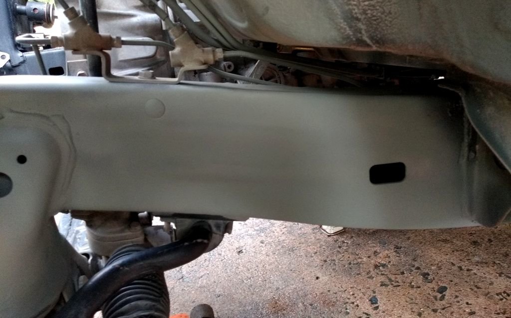

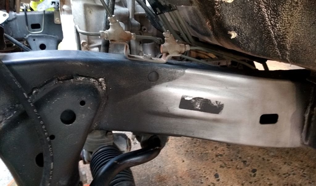

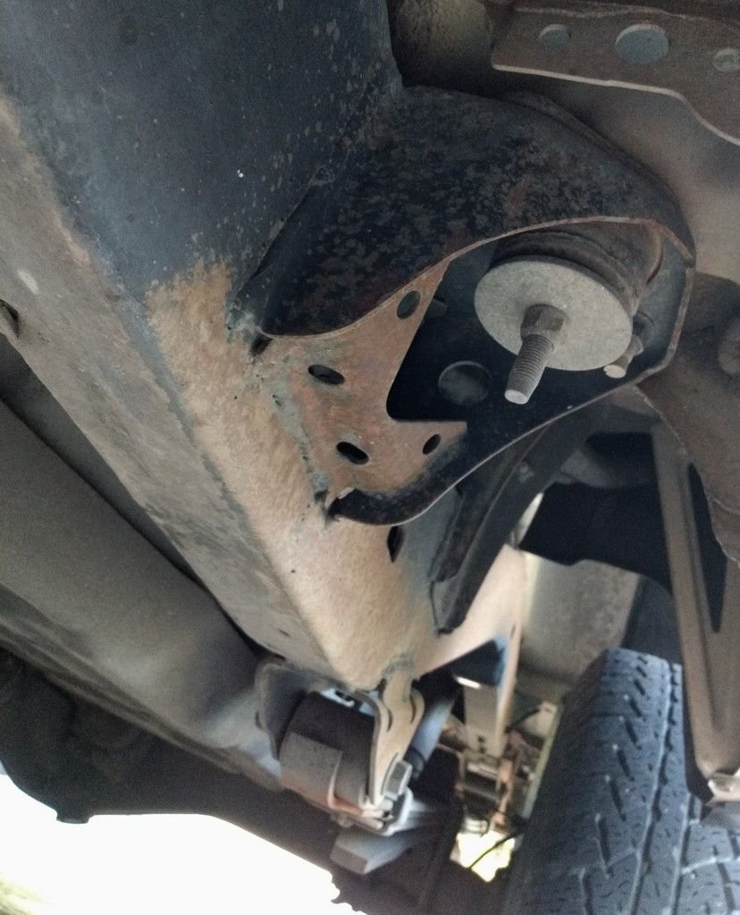

    I'm planning to clean up some surface rust from gravel on the outside of the frame for the rear like I did the front.
    The inside area of the frame is clean. I don't want to disturb the inside. So I want to keep the outside looking as good as the inside.
    Even though this truck will never be exposed to road salt or chemicals, I do like to treat the frame and parts with Fluid Film. It makes it easy when you want to remove a bolt to work on something.
    For the front, I used a sandblaster to completely clean the surface rust where the gravel wore down the original frame paint.
    Then primed it with Rust Oleum self etching primer.
    Painted it with some high chip resistant Farm Implement paint.
