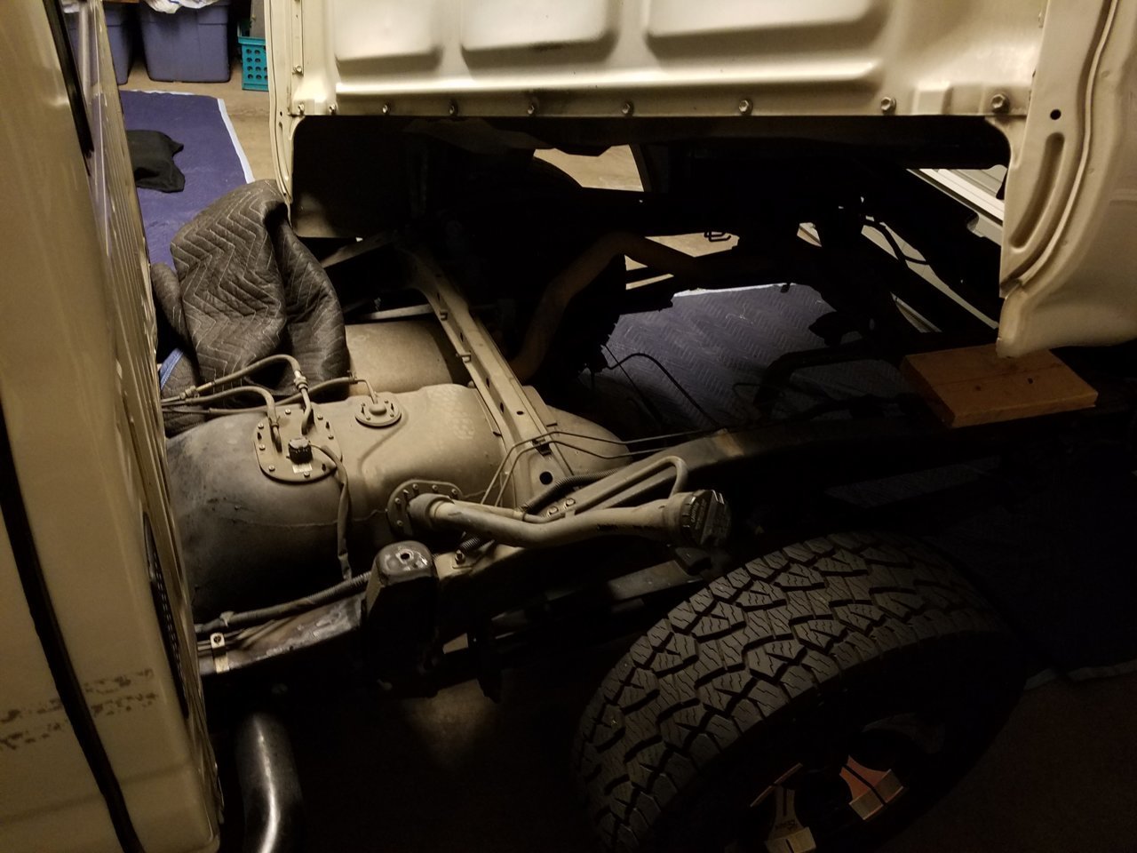

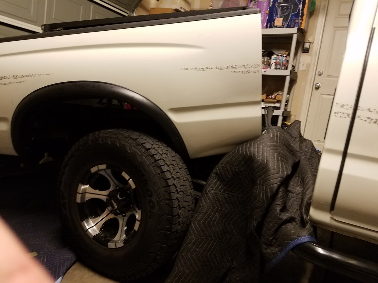

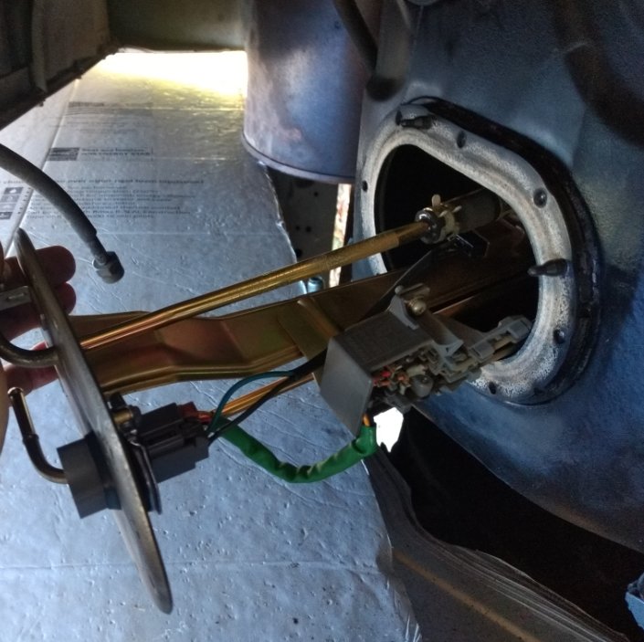

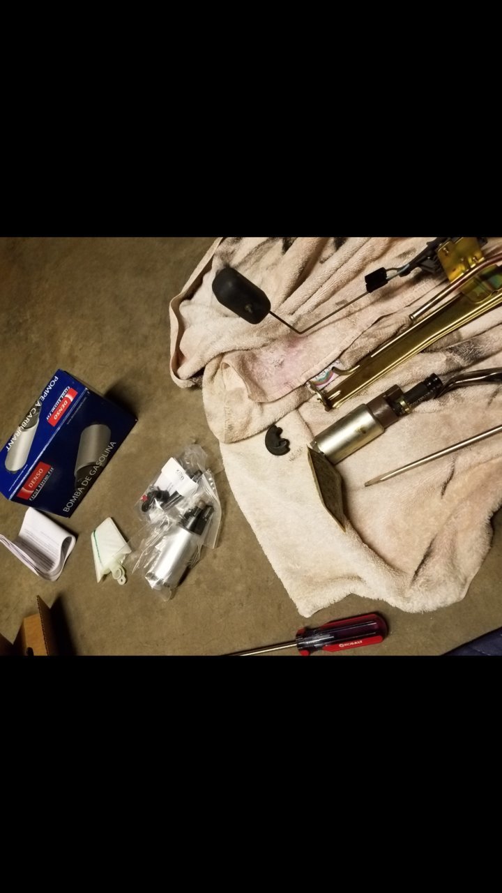

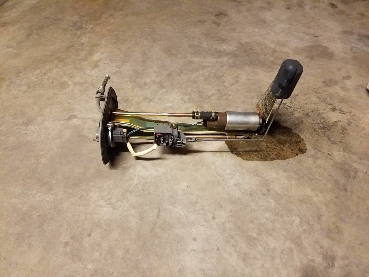

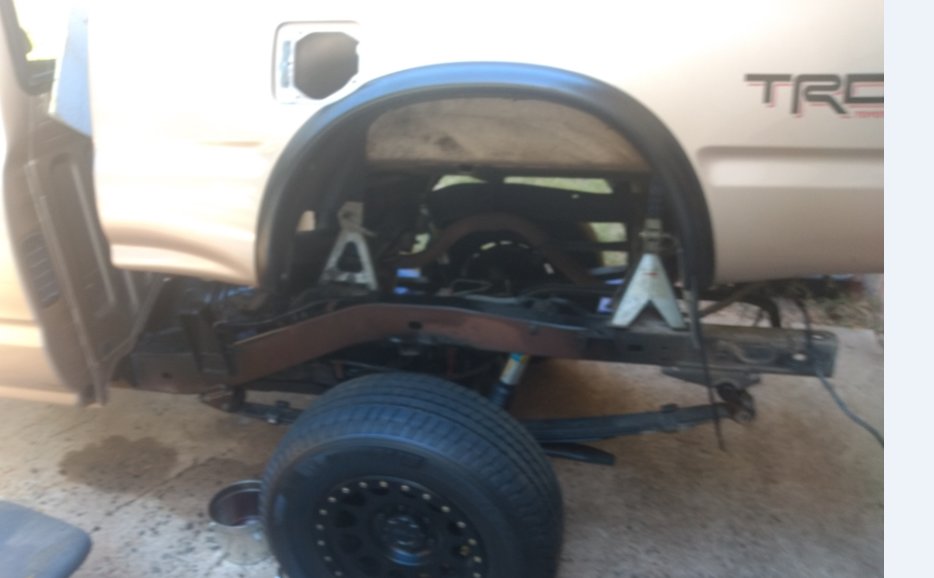

    Today I lifted the bed and changed the fuel pump. It really didn't take too much effort.
    Just in case removal started to go awry, I put a piece of foam insulation board between the bed and the cab. The foam board is lightweight and easy to handle.
    Jack stands worked well to hold up the bed at an angle.
    Pulling the pump was easier than I though.
    It runs great with the new pump and hoses.

    Did you loosen the bolts on the other side of the bed?
    GQ7227 and CS_AR[QUOTED][OP] like this.
  10. Oct 12, 2019 at 6:36 PM
    #30
    CS_AR
    CS_AR [OP] Well-Known Member
    Apr 3, 2019
    #289019
    12,900
    1999 Tacoma PreRunner TRD
    Everything but the driveshaft. B03A - 410
    Yes. I removed them so I could slide the bed backward and away from the cab.

    And what did you use to raise the one side that high before you slide in the jack stands?
  12. Oct 12, 2019 at 7:37 PM
    #32
    CS_AR
    Apr 3, 2019
    #289019
    12,900

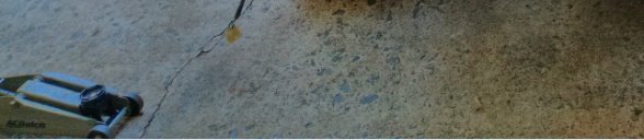

    Initially, I manually lifted it and then slid in a mini-floor jack just behind the wheel. I used that jack to get it up high enough to get one jack stand under it. Then I pulled out the little jack, and finished lifting it by hand as I positioned each jack stand in better locations. I think I could have done it without the jack. Tomorrow when I take it down, I'll get some help to push it up while I remove the jack stands.
    If you are not trying to lift off the entire bed, its not that heavy or hard to maneuver from side to side.
    Here's a picture of the little floor jack that I used to for the initial lift.

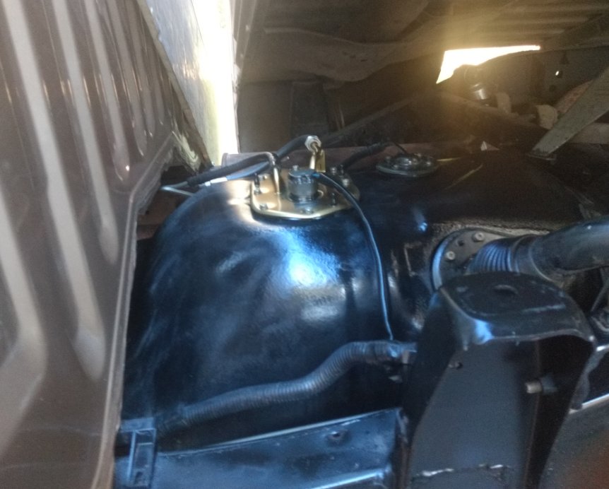

    I had to R&R the Evap Canister (was busted to shit somehow) under the bed on my Gen 1...I unbolted the driver side, loosened the pass side and used a 2x4 to raise the driver side enough to get to the stinking canister, and another 2x4 to keep it there. Didn't have any help handy, was pretty easy to do solo.

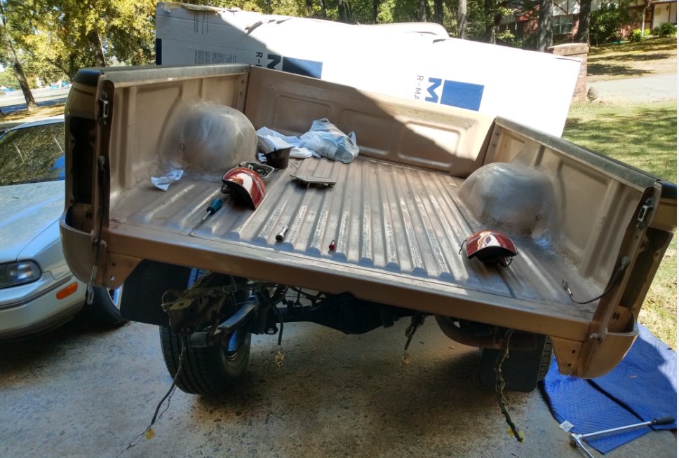

    I ended up removing the bolts and moving the bed back at an angle.
    Had complete access this way without the bed hanging over the tank area.
    Put a body jack Stand on the rear center of the bed and tilted the whole bed
    Took me about 3-4 hours because I could not for the life of me remove the one side of the high pressure fuel line.
    I was afraid I was going to break the connection.
    Lucky I was able to get one side off tho.
