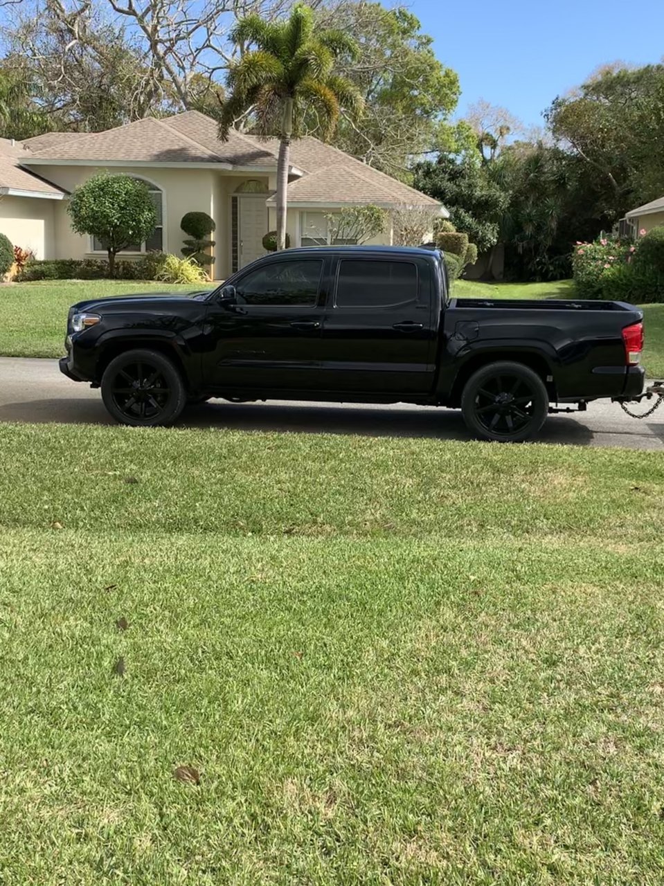

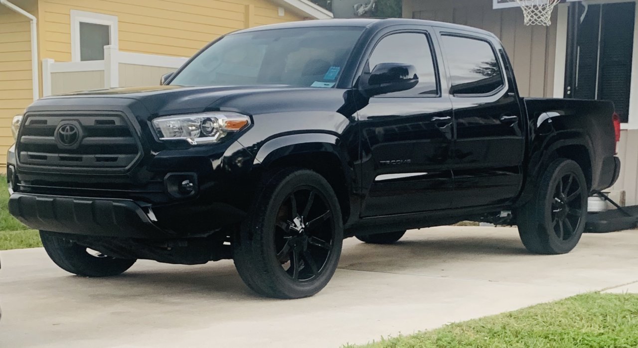

    I’ve had the SOS performance 2/3.5 kit on my 16 for about a year and a half. I have mild driveline chatter off the line spring pop at full steering lock but all in all I’ve been happy with it. If you have a load in the bed on stock shocks you will hit your bump stops but that’s the nature of the beast. I may check into having the driveshaft shortened an inch or so. And have considered eibach pro alignment upper control arms. I wouldn’t recommend any more drop in the rear without a c notch.
