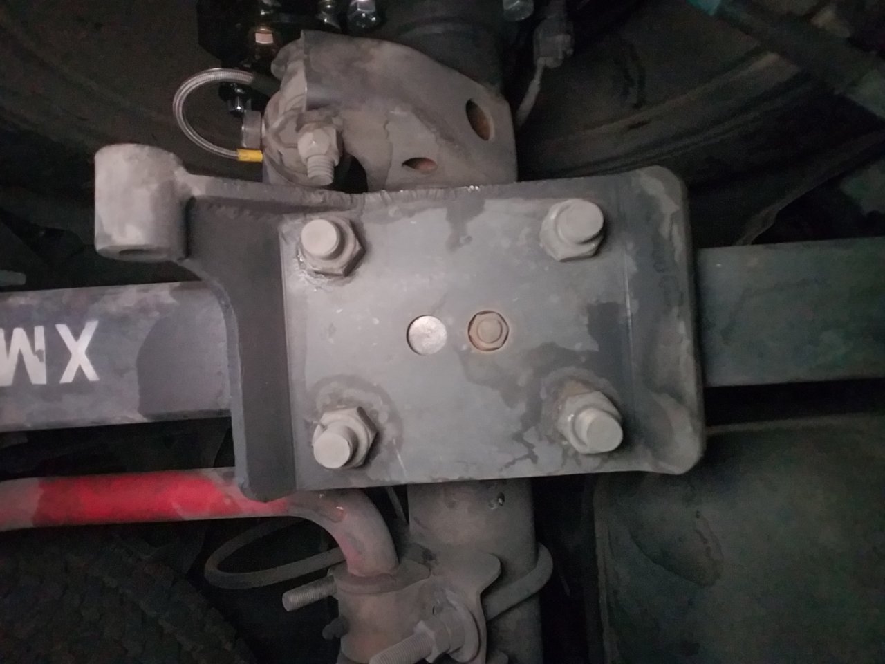

    So trying to sort this out before I pull it apart and either try some shims or abandon ship. The leaf spring pin nut inserts into the lower plate. What I didn't realize is that there are two holes in the lower plate. I don't even remember noticing that when installing. The pic shows that I have the nut in the hole toward the front of the truck. Does anyone know if this is correct?

    It should be in the hole that moves the axle towards the rear of the truck. Its to increase the wheel base ever so slightly to compensate for the now "longer" driveshaft due to lowering.
    edit- nvm the picture is of the lower plate, which doesn't affect the axle position. However, the axle perch has the hole offset to the rear of the truck.

    If I relocate the pin to the rear hole on the bracket that would move the axle back correct? Having a hard time seeing in my head. thanks

    nvm the picture is of the lower plate, which doesn't affect the axle position. However, the hole in the axle perch should be offset to the rear of the truck, but I don't think you can put it on backwards. Not sure what could be wrong. Sorry if I confused you. have you tried contacting Tom at SOS? Super helpful guy

    Yes...got an email in to Tom. Its been a week since I installed so I'm not even sure you can install it wrong. I'm just confused as to why, if its installed correct, do I have pinion angle issues. One of the other TW members had a similar issue but most do not. Thanks for the help.

    I can try check mine tommorow if I remember . But I dont think you can get it wrong because pin also goes into spring perch .If in wrong hole :sadviolin: u bolts would be crooked I Think .:notsure: .Its been awhile since I installed mine though.

    Mine same as yours .

    Thanks. At least I know it’s on right.

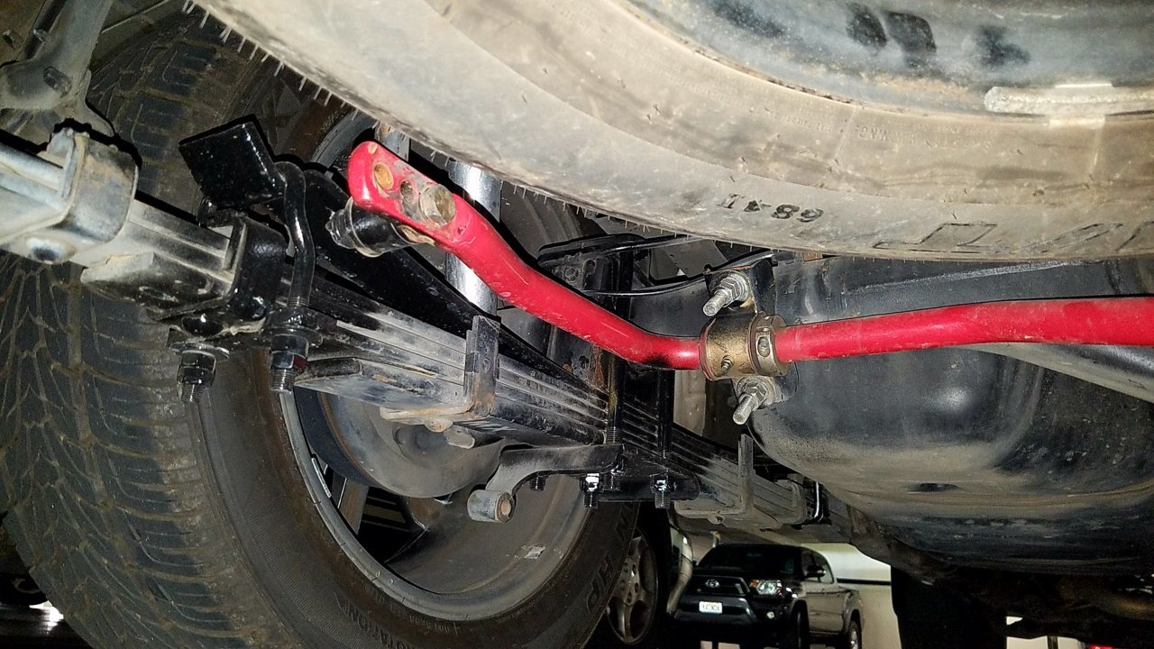

    Just notice mine has a second pin ,I added a full hellwig helper spring so forget if its related .

    Pretty sure it is .On pic I posted second pin looks new so pretty sure its related to the hellwigs
