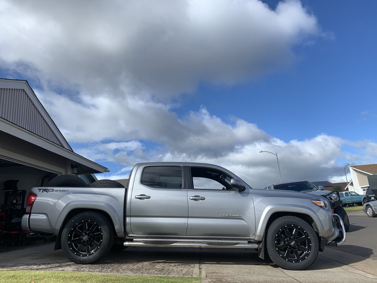

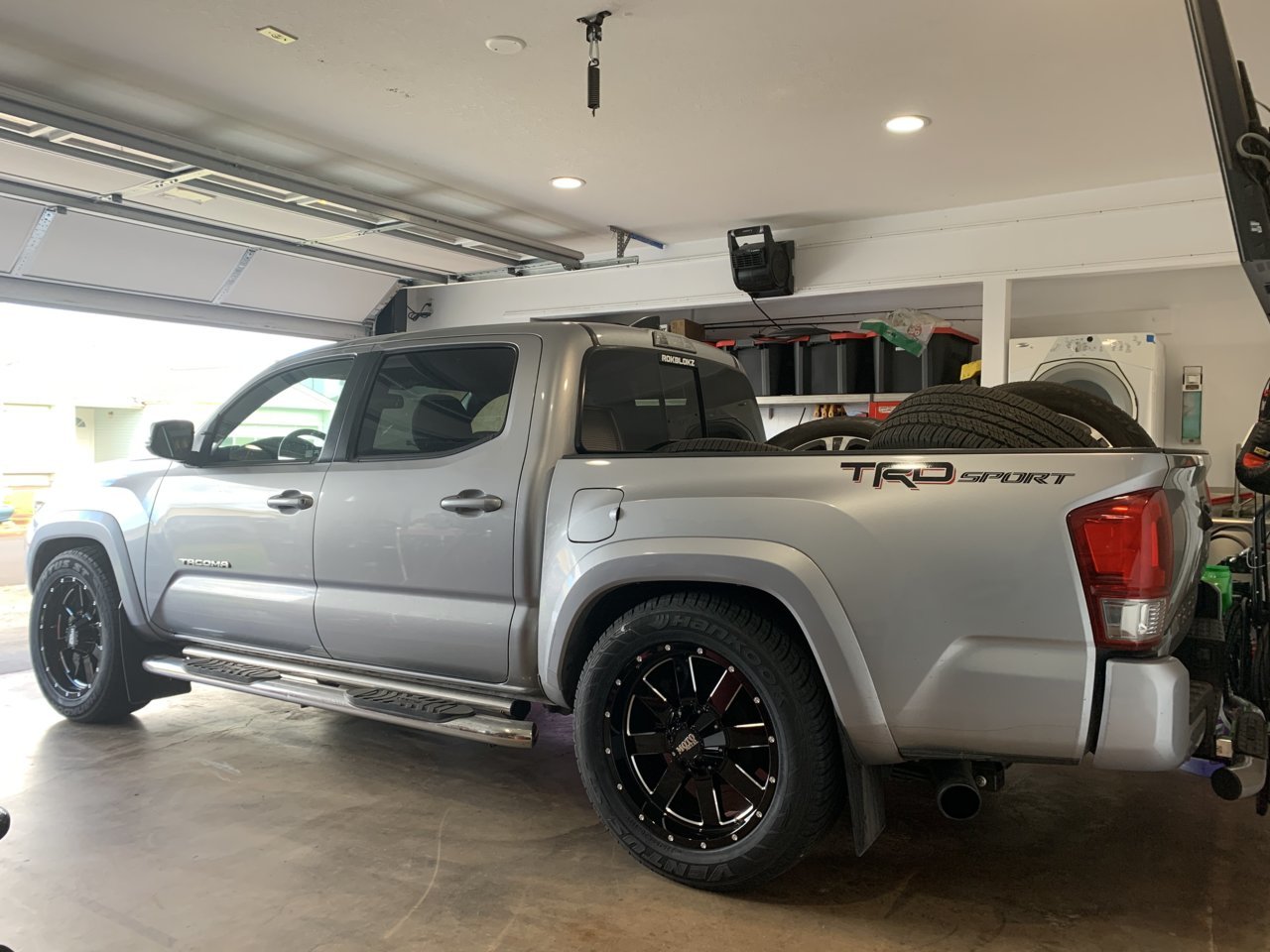

    cousins 3rd gen that I just finished. SOS kit, 20x9’s wrapped in 275/55r20 to keep the wells nice and stuffed looking.
    pinch welds hammered flat, little bit of trimming on rear part of front fender/mud flap, and a bit of heat gun massage therapy on fender liners. Rears fit no I problem

    Nice the stance .Looks good with the 275s.

    Thanks. Yeah these 3rd gens got a little more space than our 2nd gens. Thanks again for all the info

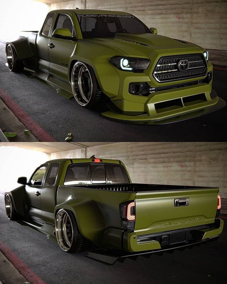

    Came across this on instagram and thought it belonged here

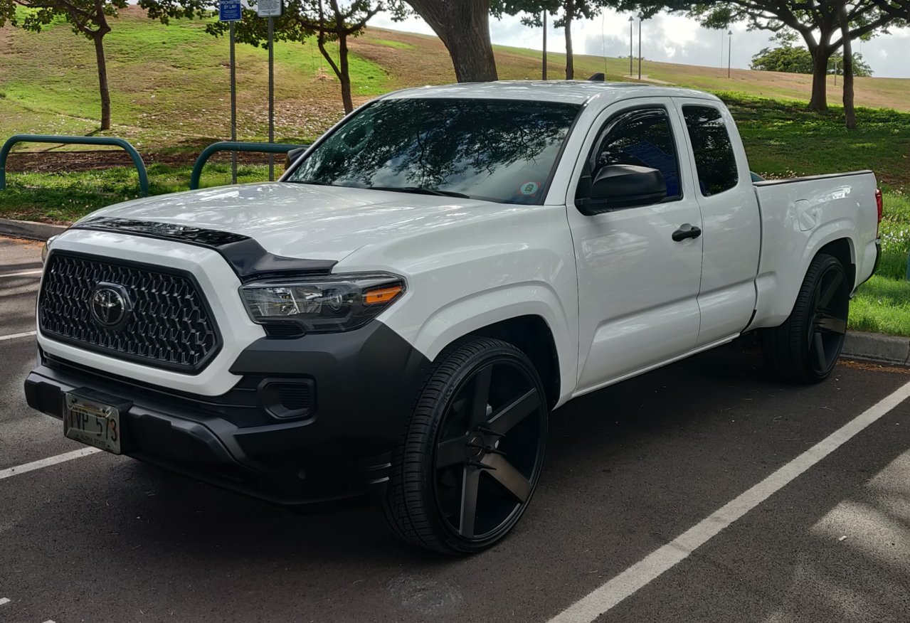

    Weathertech low profile bug shield Retrofitted headlights matte black TRD grille Lowered 3/5 24" Dub Ballaz LED lights all inside and out MBRP 3" cat back Line output converter with 500watt amp 10" MA audio subwoofer K&N air filter

    That’s a cool looking truck. Lowering with big wheels really make the look great.

    real? more picsss?

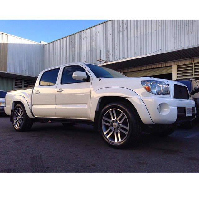

    Running 275 x50x20 tires Rims 20 × 8.5 6x 139.7 m +25 rims are 4runner replicas
    I believe factory 4runner limitted are 20 x 7 in .

    265 x 50 x 20
    same rims with out powder coat .

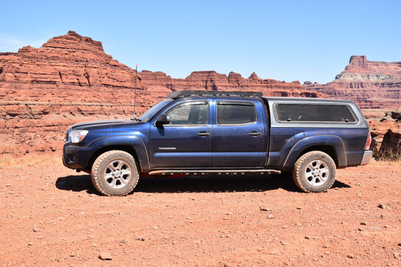

    Also, does adding a shit ton of weight from sliders, skids, etc to stock suspension count? This was pre-lift :D
