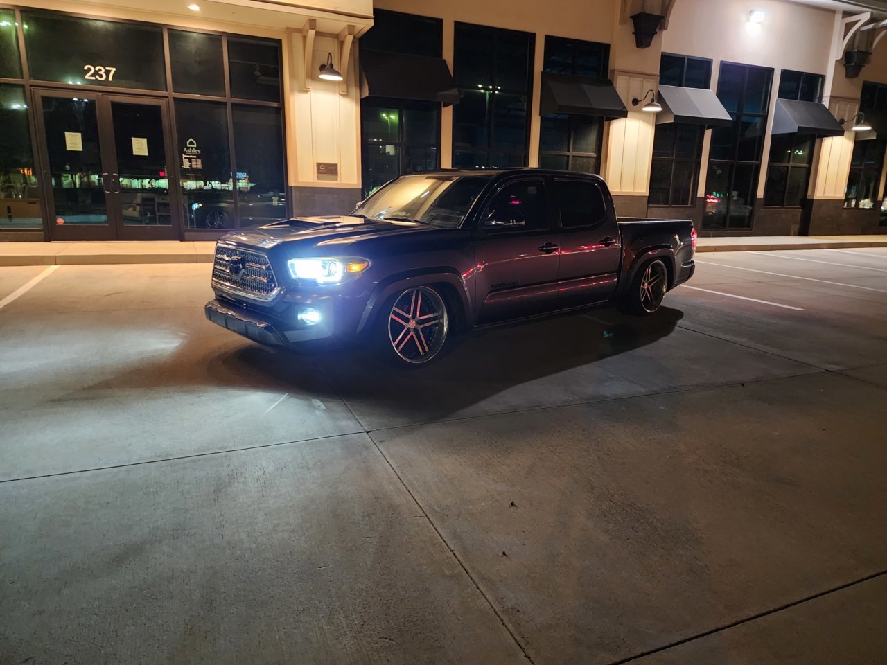

  1. Dec 27, 2022 at 8:50 PM
    #381
    967tow
    967tow Member
    Dec 17, 2022
    #413474
    16
    Peter
    Bagged taco
    Lots can't list

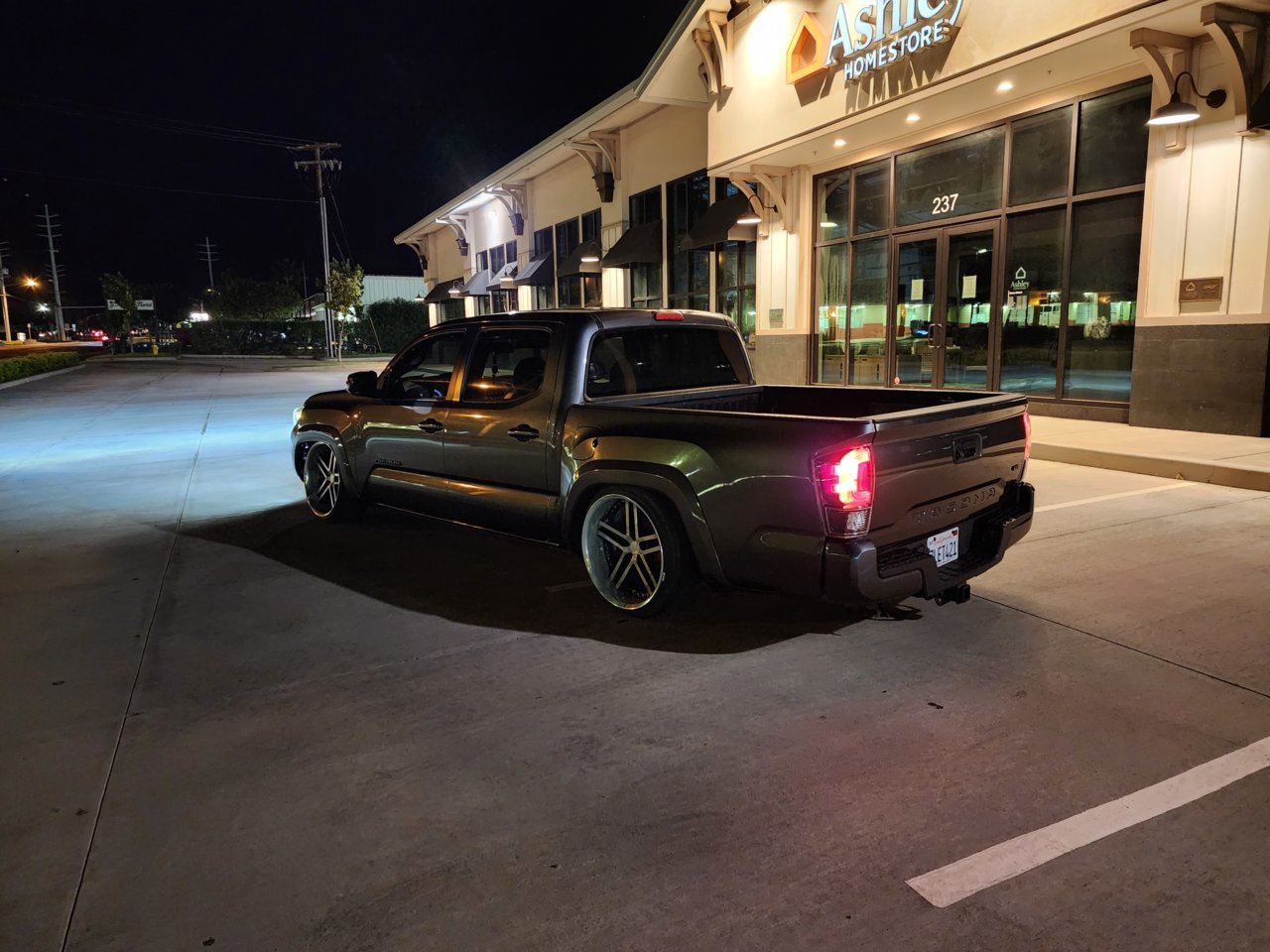

  2. Dec 27, 2022 at 8:51 PM
    #382
    967tow
    967tow Member
    Dec 17, 2022
    #413474
    16
    Peter
    Bagged taco
    Lots can't list
  3. Dec 27, 2022 at 8:52 PM
    #383
    kevjitzoo
    kevjitzoo Well-Known Member
    Jul 14, 2018
    #259328
    101
    Kevin
    Seattle, WA
    2019 Toyota Tacoma TRD Offroad
    Need bigger wheeeeeeels and more offfffffset!

    A few
    Nice work :thumbsup:
    967tow likes this.
  5. Dec 27, 2022 at 8:56 PM
    #385
    967tow
    967tow Member
    Dec 17, 2022
    #413474
    16
    Peter
    Bagged taco
    Lots can't list

    Bagged?
  7. Dec 27, 2022 at 9:01 PM
    #387
    967tow
    967tow Member
    Dec 17, 2022
    #413474
    16
    Peter
    Bagged taco
    Lots can't list
    Yes it is
    kevjitzoo likes this.

    What’s the appeal of putting a vehicle on bags?
    Not hating, it’s just so impractical?
    Ricardo13x likes this.
  9. Dec 27, 2022 at 9:09 PM
    #389
    967tow
    967tow Member
    Dec 17, 2022
    #413474
    16
    Peter
    Bagged taco
    Lots can't list
    Just wanted to be different bagged 4dr taco u know of any other yet

    Thats the world of customization . Do what you want . Whats impractical for one is totally awesome for others . The airbags can adjust to different heights so when driving raise it up to drivable height . Not hating .Just my take .

    That's a clean build! I love the idea of modern mini trucks laying frame like the old hard body Nissans.

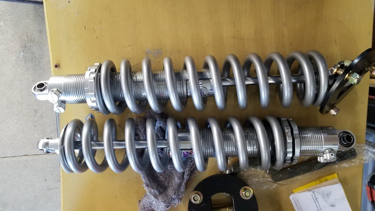

    Is there anybody making coil-overs for these trucks. I'd like to buy a new Tacoma but only if I can lower it more than just a few inches.

    Need to piece together a set . Used Dirt King strut mount withe viking dual adjustable coilovers and eibach springs . This is for 2nd gen tacoma. Need to measure the ride height you want then order the correct coilovers according to your ride height . I was off about 5/8 in off and had to order 2in mount to replace the 1in one it comes with . Was lucky didnt damge coilovers

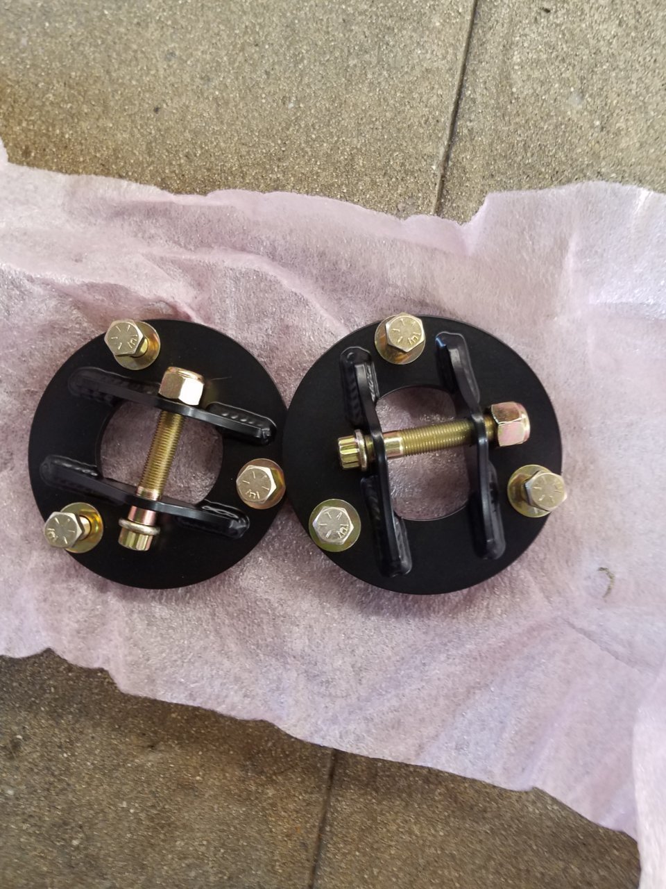

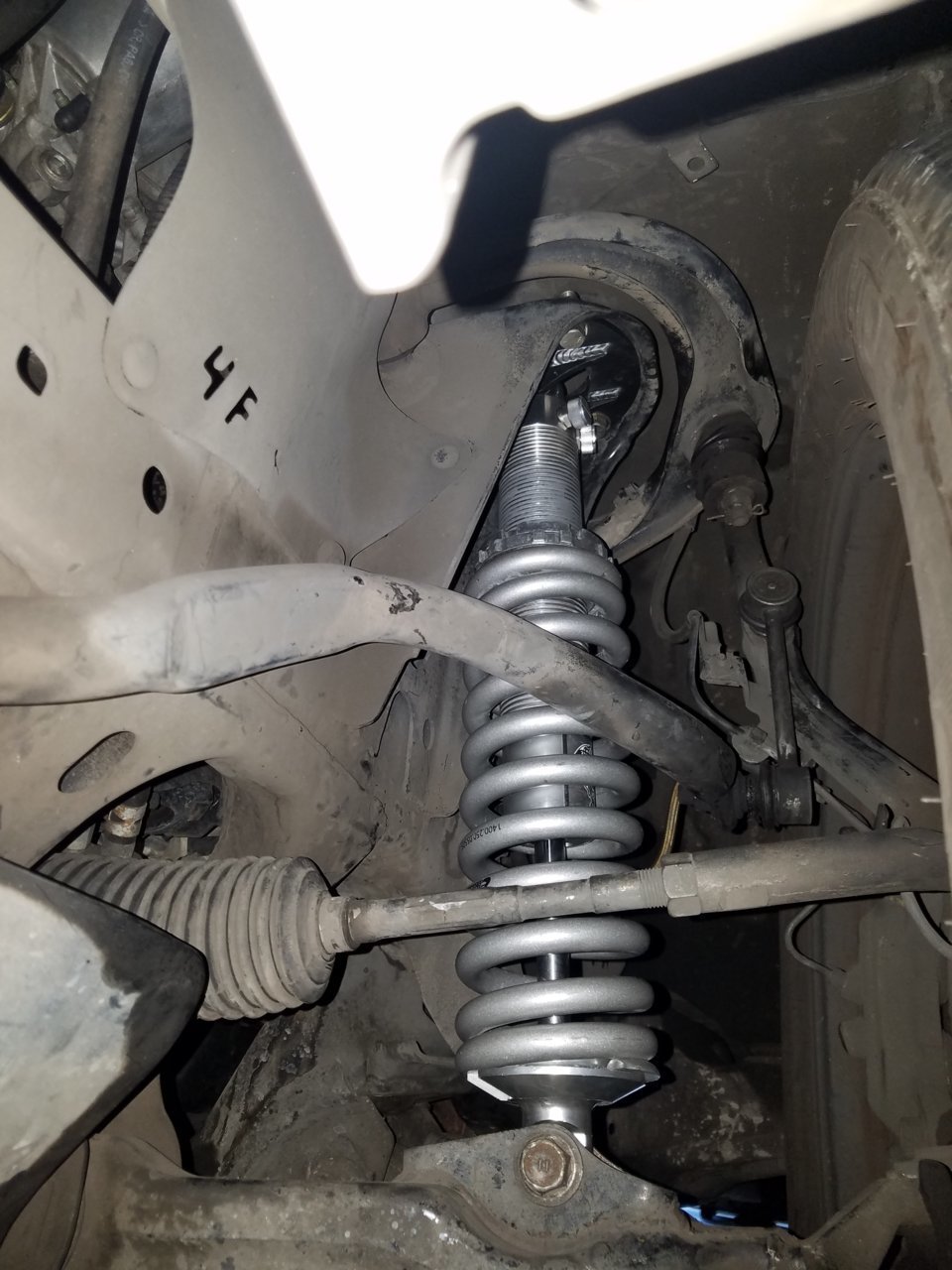

    With 1 in longer shock mount
    Can go lower than SOS kit but best part is adjustability of dampening. Im about 1/2 in lower than SOS kit but alignment still within specs .

    Also had to reorder spherical bearing with longer mounting bushing and insert for 14mm bolt ours are mounted with.
