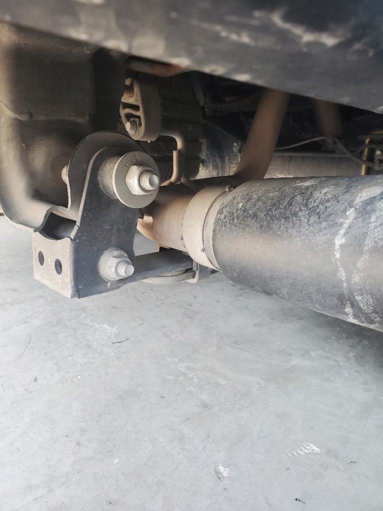

    The exhaust makes a 90* turn from front to back, in order to exit the side of the truck. It crosses the leaf pack near the rear shackle and interferes with a leaf spring keeper that has rubber bushings on it. The easiest solution appears to be to cut the exhaust before the turn, & leave it under the truck or have it extended out the back, so as not to cross over the leafs at all. Another solution would be to section the hanger, and move the exhaust up a little to clear.
    Not mine, but here you can see the problem.

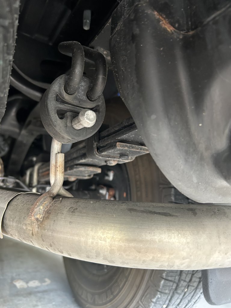

    This is how it looks stock, with the exhaust below the leaf pack. The kit puts it on top as shown in my previous post. I'm going to hack mine off about 1.5"-2" behind the hanger & before the bend, install the kit, and leave enough pipe behind the hanger to extend the exhaust after.
