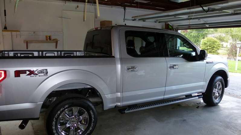

    You can get into a new one for the same price as a tacoma.I bought this about six weeks ago and paid $39,000.So far I love it.5.0 v8,crew cab,I'm getting 18 mpg around town and over 22 highway.I need to update my avatar.P1010775.jpg

    That's awesome! Any issues so far? Did you get the fancier dash and leather/pleather?

    No issues yet.Heavy duty tow,E locker,trailer backup assist,3.55,Sync 3.0.It's huge!But it fits in my garage.:thumbsup::bananadance:The only thing leather is the steering wheel.But the seats are very comfortable,they're also heated which is a plus in the winter.I like it.
