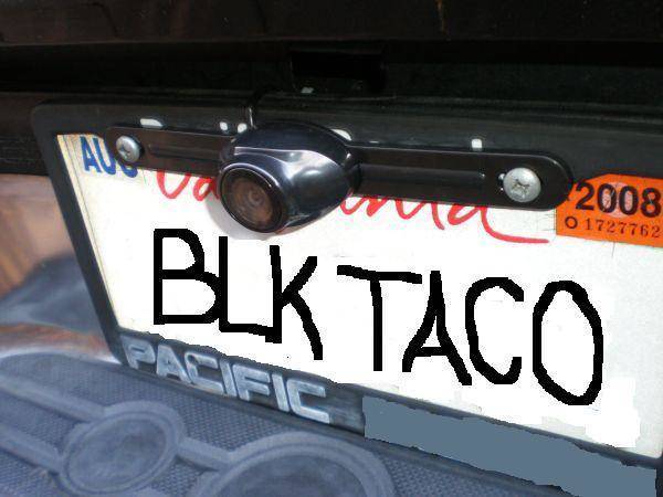

    death valley fan i did the same thing bought it at kragen for 50 bucks and its wireless and in color looks good and its cheap in price
    Heres a pic of it mounted.
