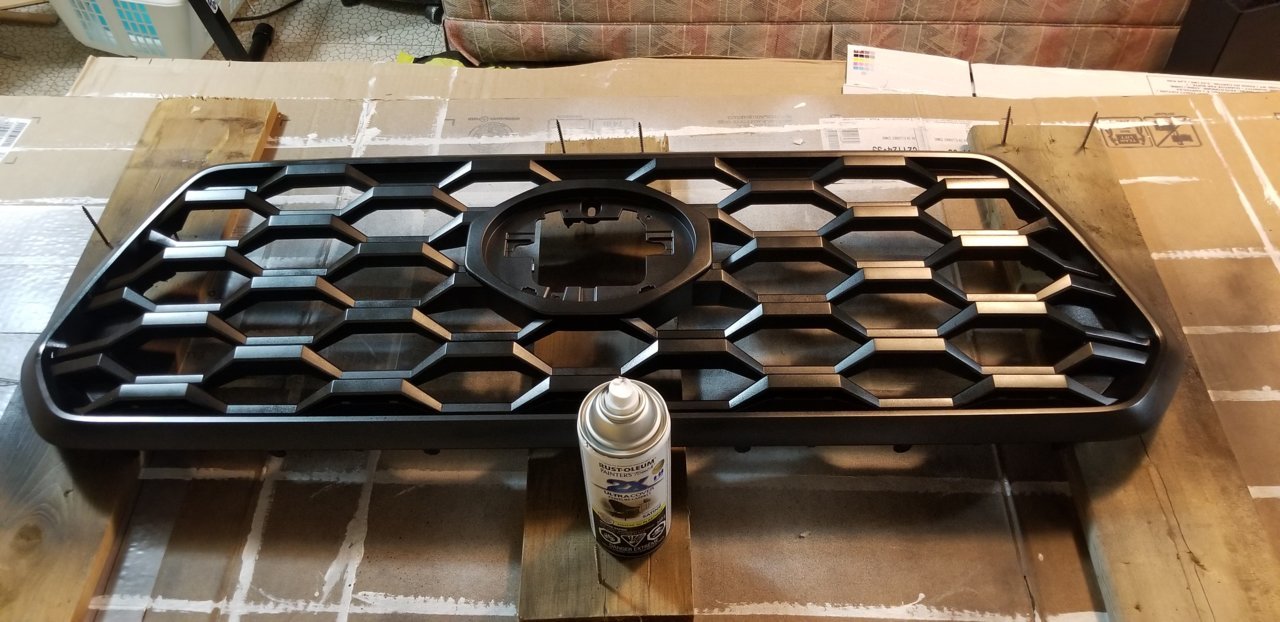

    Im painting in the basement. It's 0 C outside.

    I think I'm done for now. I prepped it with degreaser, sand a bit and wipe it with alcohol. I put 5-6 thin coats. Will let it cure for 48 hours before I install it. This is the paint I use. Hope the paint will last long.

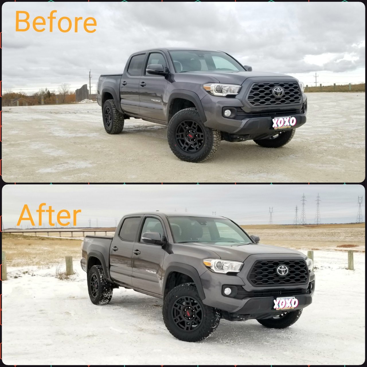

    Just wanted to share my before and after. Really happy with the result.

    Looks sick!!! Such a subtle change makes the front end look so much more sleek.
