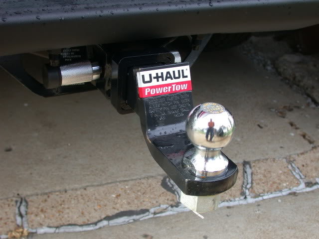

    You have a 7 pin plug? But no tow package? That is odd. A factory mounted 7 pin harness/plug? As far as I knew that was something that is either added after or comes with the tow package.
    So in other words your truck looks like this:
