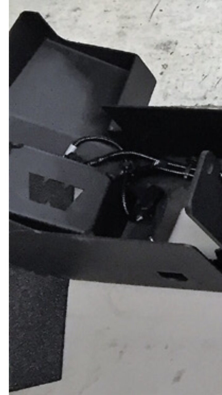

    I hear what your saying but, on the Warn Bumper the have two cutouts in the shape of a W in essentially the same place as where the C4 has the plastic covers. If the sensors mount behind the W there would be no metal to obstruct them. B96B6F0F-7FE4-4B9E-B273-299FD2A9C453.jpg
    C45D9D80-1E47-4BB7-8888-F270F0BE622B.jpg I just don’t see anything to attach the sensors too.

    Very interesting! Its hard to tell the size from those pics, but the BSM sensors are pretty damn big, so that W wouldn’t be quite big enough to fully expose the sensors. Anyways, this is all speculation so hopefully someone chimes in with real world experience.

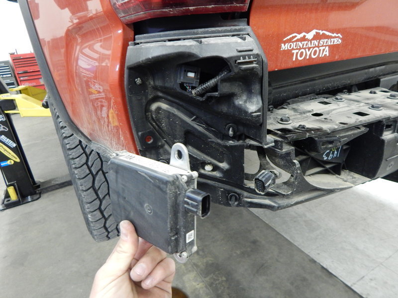

    Just for information this is the sensor. It also controls the rear traffic collision avoidance system. That’s the one the beeps at you if your backing out of a parking space and Johnny Jones in his new Mustang daddy and mommy bought him, is racing through the parking lot. 9365D189-1D9B-48FB-9539-D9E9613F8649.jpg

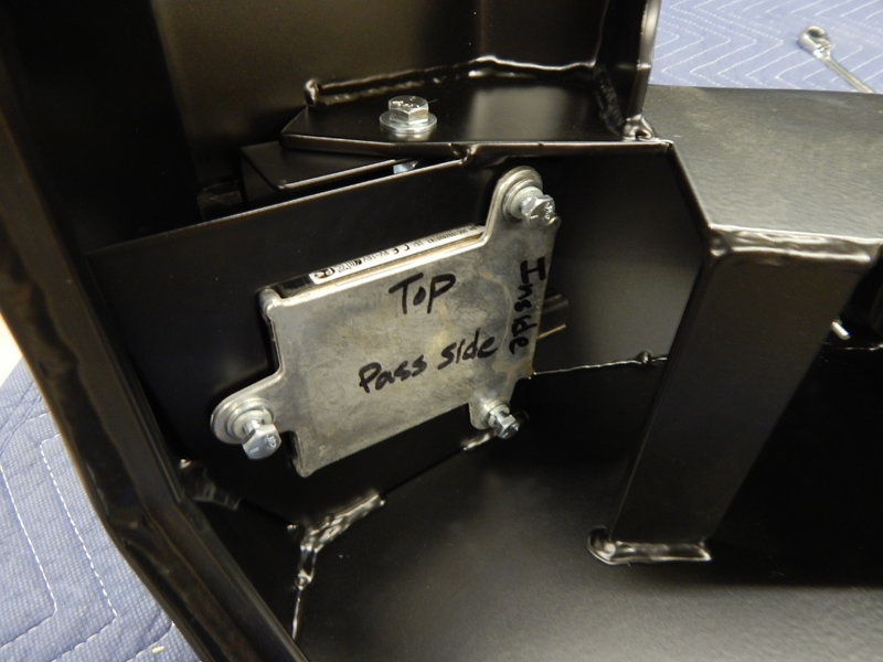

    Warn might be able to pull it off with just a few modifications to their bumper. Maybe a little bigger W opening with a plastic piece in front of the sensors.
