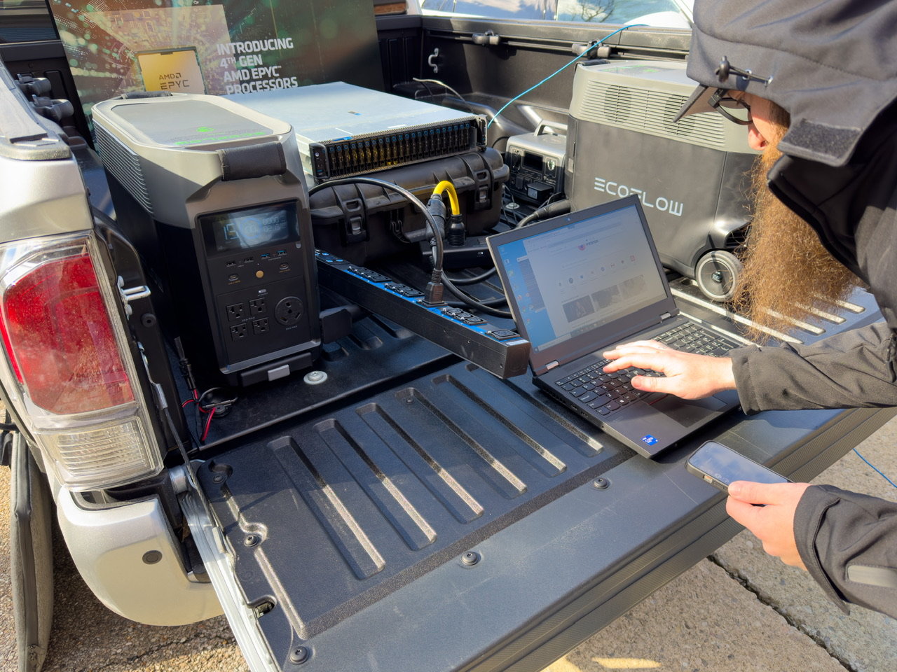

    Running into a small issue with my new Tacoma where I need a bit more power out in the field. Has anyone installed a larger inverter? 100W driving around just doesn't cut it.

    Man, I hope those are SSDs in that chassis ... :D

    It's Gen4/Gen5 across the front.

    Not sure the truck electrics could handle it. Best option would be a dual lithium battery set up with a sine waver inverter and a DC/DC charger.

    I found that my EcoFlow Delta 2 does not like the non pure sine wave A/C output of my '17 Tacoma's inverter.
    And I have the 400W anytime mod.
    If I were working with that much tech ina Tacoma, I would install a true sine wave inverter from Redarc or similar system.
    As it sits for me, I charge my EcoFlow with 8amps D/C from a dedicated circuit I installed under the passenger rear seat with 10awg wiring.
    Otherwise, 200W of solar to the EcoFlow while parked. I only run a fridge and recharge USB stuff.
    MGMoverland likes this.

    I haven't tested it but I did partially assume that built-in inverter wouldnt work as well as just using the DC-out to charge a battery. I have a 220W folding panel right now and a 200W flexible panel for the top of a camper shell.
    Things get fun when you have 7200W on tap in your trunk :-D

    Although that does give the 400W anytime (same unit I have), the Tacoma inverter is not pure sine wave. The EcoFlow units are very picky regarding this seemingly small issue.
    My Jackassery 1000 didn't give a crap what quality the inverter sine wave is. It was also throttles to about 168W input even though I had 400W available.

    I’d add up your usage, and list it. All that stuff might not be able to run off the alternator’s output. Looks like you might need a generator or a dedicated additional alternator to run.
