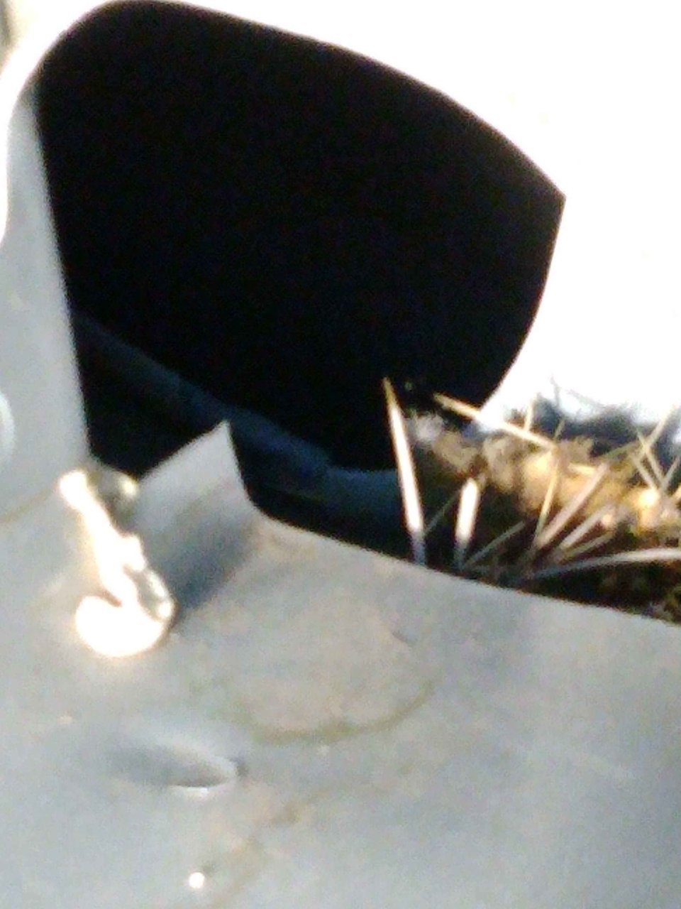

    1. Toyota might be using soy-based wiring that attracts pack-rats and rodents. Rodents are drawn to the smell/taste of soy-based wire insulation. This has been reported by owners from many auto manufacturers.
    2. Toyota has been improving designs but still hasn't got it entirely satisfactory. My direct experiences of ownership are 1997-2001-2015 Tacoma 4x4 trucks which had NOTHING to keep animals out of the vents for engine air-intake and cabin ventilation. Worst situation was pack-rats in the air-intake for the 2015, eaten through heavy pleated engine air filter, scurrying past into the air intake to the fuel injectors, sh*t all over everything with droppings going into the intakes, along with small rocks, gravel, plant parts, seeds, etc. The bastards ate out the AC duct-work system behind the dash, holes and chewed up edges, wiring, the small pieces for nesting inside the dash. Seeds, plant debris, excrement, etc. all over the place.
    3. The 2019 Tacoma 4x4 is focus for this posting. All attached photos are for the 2019 Tacoma but could be applicable to 2018, possibly 2017, not sure. Definitely not 2015 because I had one and they are different. The nightmare experiences with pack-rats and mice were inducements to examine things more critically. I don't know if anything I post is a solution but posting this information to inform and possibly help other Patriotic Americans. The solutions appear simple, but nothing is really all that simple with rodents, etc. The attached photographs should be testament as to the seriousness of damages caused by these little bastards. I've only had the truck bout 8 months and look what they did!

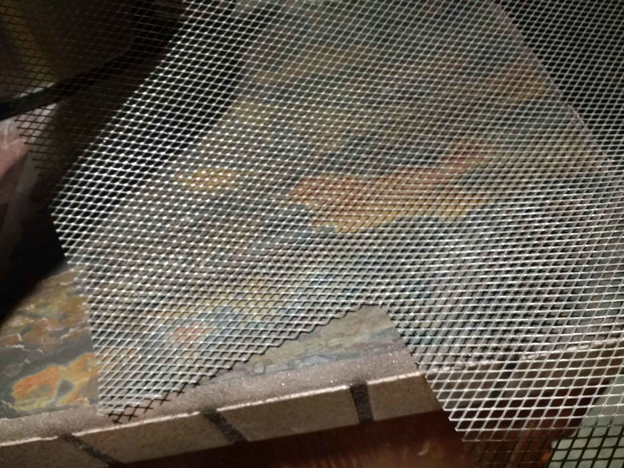

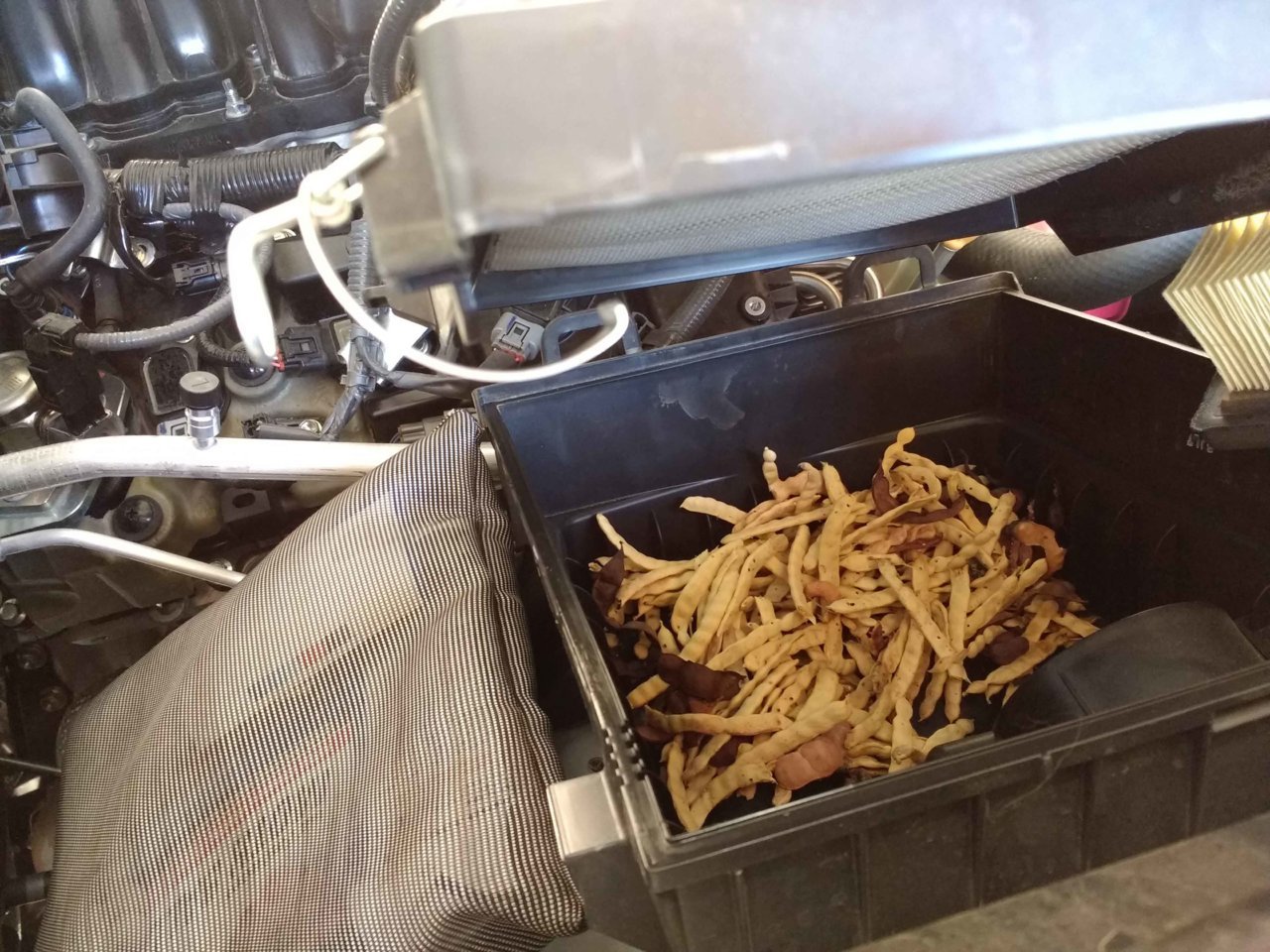

    Description of Actions:
    A. Remove the filter box for the air-intake and pull it out. Only 3 bolts to remove this box. The box has a round extrusion that extends into the fender. This fender cavity is where the "fresh air" for the engine and also the cabin, are drawn --- just above the front right wheel, the fender cavity. There is no need to access the cavity unless pack-rat debris or a dead animal is trapped inside. I've never removed the plastic partition above the wheel so cannot tell you how to do that. But i did blast the inside of the fender cavity with high pressure garden hose to flush it out. Unfortunately, I could not see anything and as far as I know, nothing came out. There are likely openings under there, since the pack-rats have found a way inside. Toyota design should completely screen or seal that cavity as some of us live in very wild areas and that cavity is attractive to wildlife.
    B. Clean/disinfect everything-rodents carry diseases. Used a spray cleaner from Clorox with bleach (of course), says it kills 99.9% of everything. Hopefully, not humans. Probably good idea to wear rubber gloves and only in well ventilated areas. I removed the entire intake box and scrubbed it down/disinfected in a utility sink. Then to rectify the problem, felt that blocking off the rodent entry path through the round tube extrusion by covering that hole with screening. This is the air-intake from the fender cavity. My method was to use two screens, one for outside the box, and one for inside the box, all squeezed into the round tube/hole. Screen material is probably aluminum used for drywall work, easy to cut and "mold." Photo of screening material is attached. The round tube hole size is 3.5 inches, but a little over-size allows for squeezing the screening into the round hole. An epoxy might be needed to ensure that the screens remain in place, but I am going to skip for now, it's messy and permanent, and see what happens since I know what to do now. Concerns with reduced airflow due to the screening will be by monitoring fuel economy.

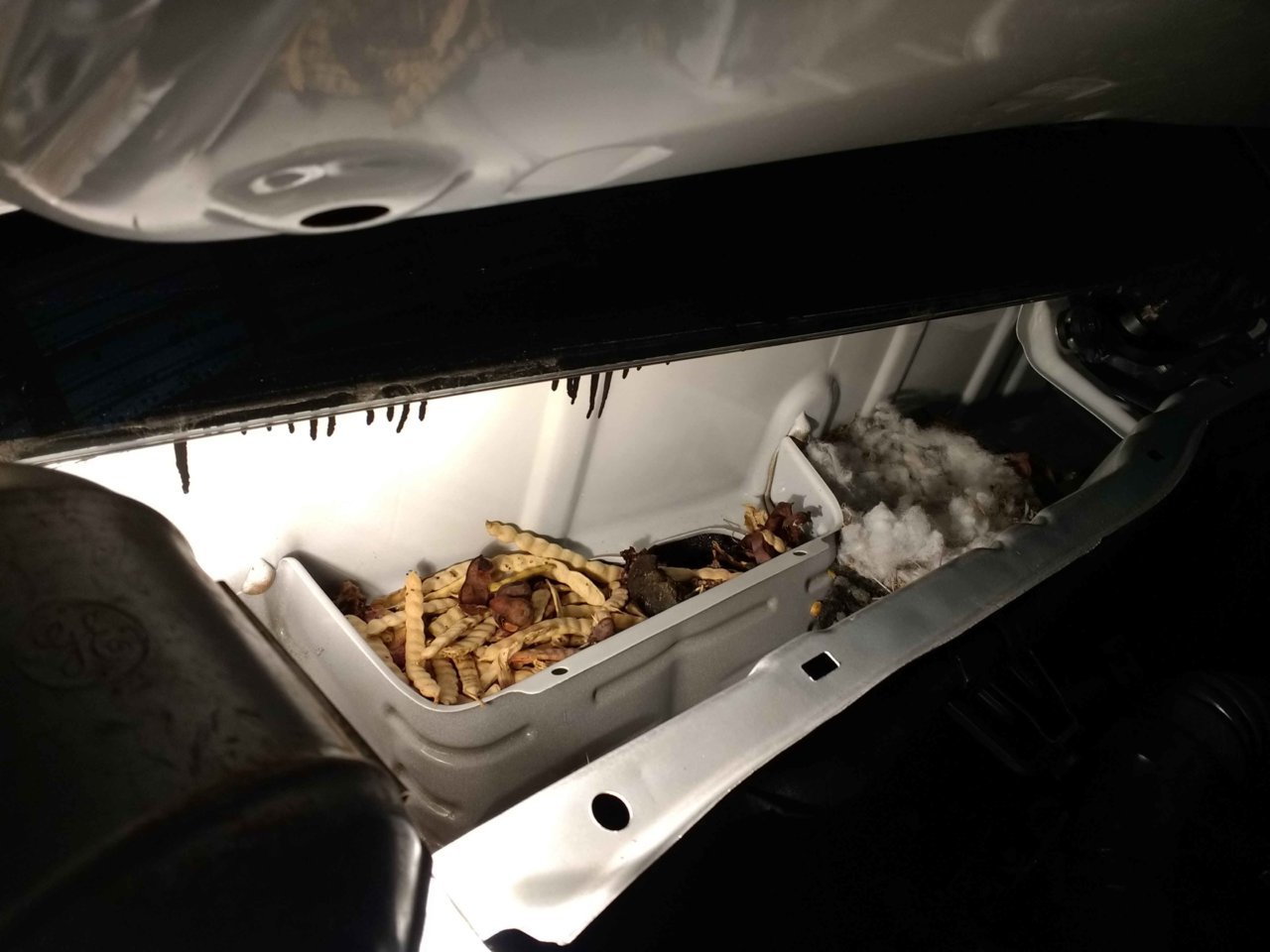

    Now for the worst part -- the cabin air intake.
    C. From the attached photos, note that it is a disaster. First step--clean everything up. A shop vacuum is handy and a good washing to remove stains and clumped crap, then Clorox with bleach to top it off. The rats ate the foam filter that covered the intake, or the intake hole that draws air from the fender cavity. I don't have a replacement yet as the pack-rats completely shredded that thing. That's where the cotton bunting and gray spongy material is from as seen in the photos. The copious bean seeds are Mesquite tree beans and a main staple for pack-rats for consumption during the winter.
    D. The air intake for the cabin cannot be easily seen because it is somewhat recessed. Very easy to miss, but check out the attached photo. This hole connects the windshield wiper well with the fender cavity to allow fresh air to flow from the fender cavity (same as the engine intake) into the cabin and AC system. This is path that rodents used to access the wiper well and chew up everything, pack seeds, trash, excrement. I haven't done anything with that hole but will consider screening it off by cutting out a piece of screen and placing it over the hole held by permanent epoxy. I'm not sure just yet because the shredded filter may need to go back on there. I may do away with the filter if that is what it was.
    E. Possibly adding an another layer of screening underneath the wiper well cover, epoxied into place. Just a thought.
